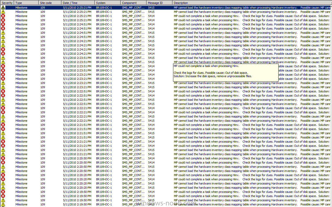

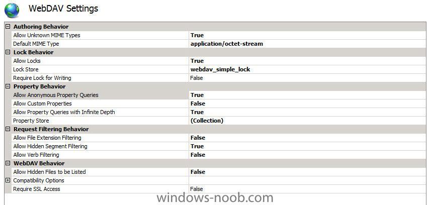

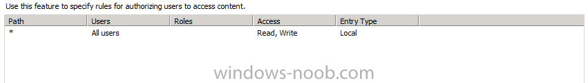

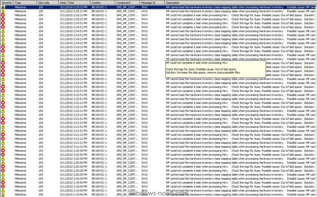

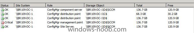

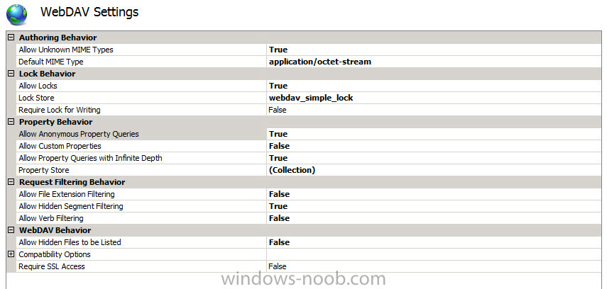

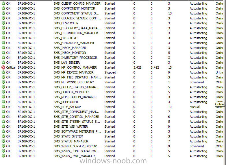

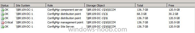

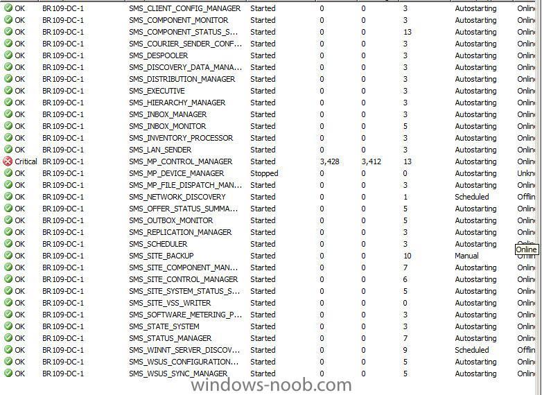

Ill need to try to get our webex info from help desk... for now here are Screen Shots of Site Status
