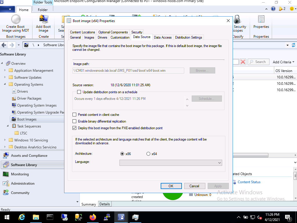

Hello.  Yes, I have that setting enabled on my boot image.     In my BIOS on my target laptop I have enabled secure boot, UEFI, PXE.   I have tried with RAID and with ACHI.
