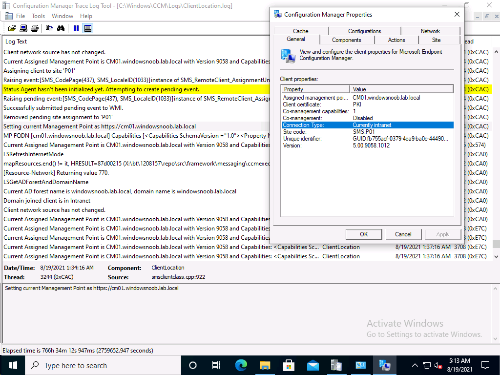

anyweb Posted August 19, 2021 Report post Posted August 19, 2021 you should be able to see from the client based logs which MP it's currently attached to and when it switches... Quote Share this post Link to post Share on other sites More sharing options...
Tommy75 Posted August 19, 2021 Report post Posted August 19, 2021 The CMG MP connect is successful. I guess my question is, if the client runs a TS whilst pointed to on-prem MP, and then halfway through switches to the CMG, will the TS recognise this or would you need to restart it to allow it to communicate with the new MP, or is it clever enough to realise it needs work off the switched MP? Quote Share this post Link to post Share on other sites More sharing options...
anyweb Posted August 19, 2021 Report post Posted August 19, 2021 over time it will switch MP, now whether it'll do that during the task sequence I don't know, you want to save time so.. my point with the variable, is why not set the variable after the reboot to the CMG MP, have you tried that ? Quote Share this post Link to post Share on other sites More sharing options...
