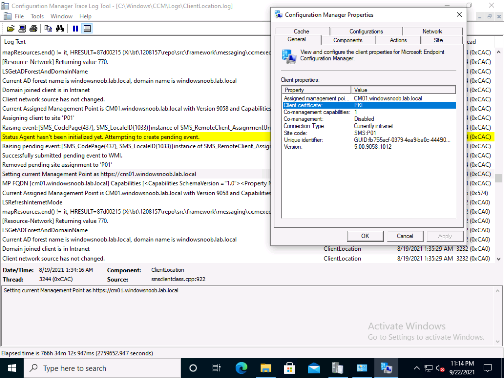

if you want to really test PKI is working then try pxe boot (operating system deployment), if it fails you'll see it failing quickly in the logs, and that'll be a clue that you've missed something,
also, on PKI managed clients, your configmgr client agent should report that the client is PKI, like this...
