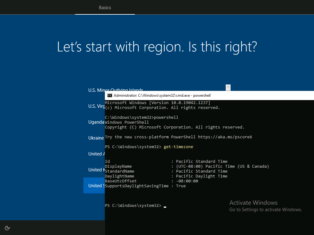

To understand why this was happening we had to look at our Windows Autopilot PC's were delivered from the vendor. Windows Autopilot delivered computers come with a timezone of Pacific Standard Time, which is from Seattle, the home of Microsoft. If you press left-shift and F10 during the first screen in Windows Autopilot OOBE and run the Powershell command below, it would return this info.
get-timezone
If the computers system time (BIOS) was different to the configured timezone, then we'd have time sync issues which would show themselves later as the on-premises network disallowed access to time.windows.com.
