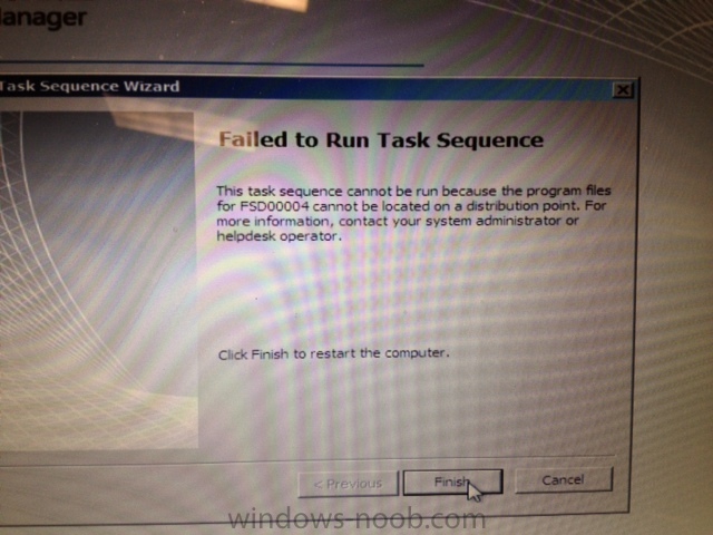

Hello! This is my first post, and I am new to SCCM 2012 (but used SCCM 2007 a fair bit).
I have been following Anyweb's guides in my test environment, and have been having issues successfully booting the Build and Capture images (Step 10 http://www.windows-noob.com/forums/index.php?/topic/4468-using-sccm-2012-rc-in-a-lab-part-7-build-and-capture-windows-7-x64/ ) . I am able to boot both x86 and x64 images, select the task sequence, but then immediately I am hit with: “Failed to Run Task Sequence - This Task Sequence cannot be run because the program files for <package_ID> cannot be located on a distribution point.”

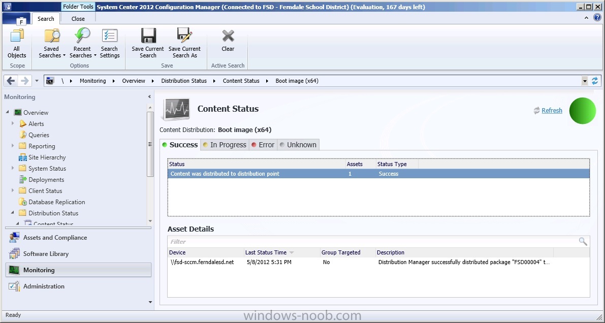

I have verified the package in question is in fact on the question (the package in question is actually either my x86 or x64 boot image).
I do have the "Copy the content in this package to a package share on distribution points" checkbox checked on the package as well!
I have tried on both x86 and x64 computers, with Broadcom and Intel network chips (trying to rule out driver issues as I experienced many in WDS deployments). Any ideas where I should look next? I'm really at a stand still on this!!
