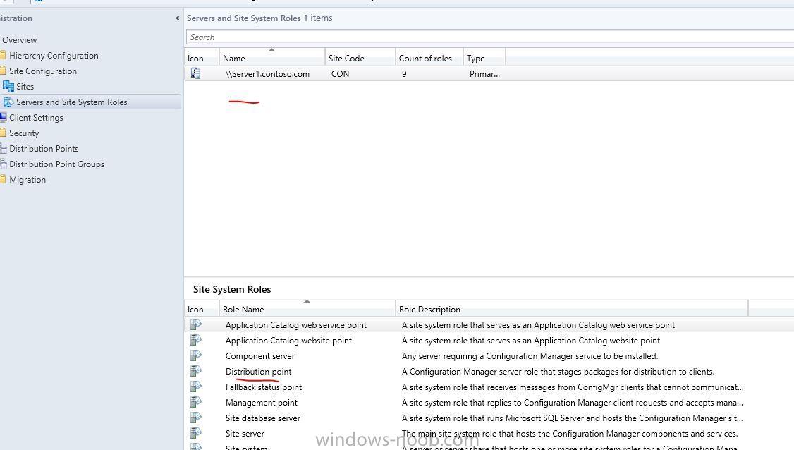

i am trying since several weeks installing sccm 2012 in a testenvironment and i am unable to get the distribution point up and running.
I am not sure if i am just to silly or if i am doing anything wrong here.

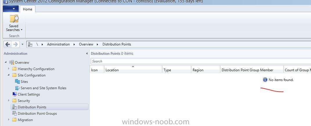

My main issue is that i do not see any distribution point in the section Administration > Distribution Points (no items found).
I have one Primary site server and the distribution point role is installed.
I also do not see the virtual directory in IIS and also do not see the smspkgc$ share on my drive.
