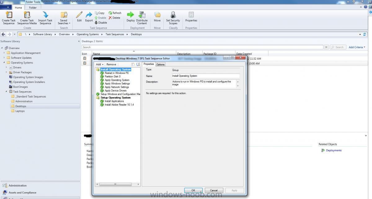

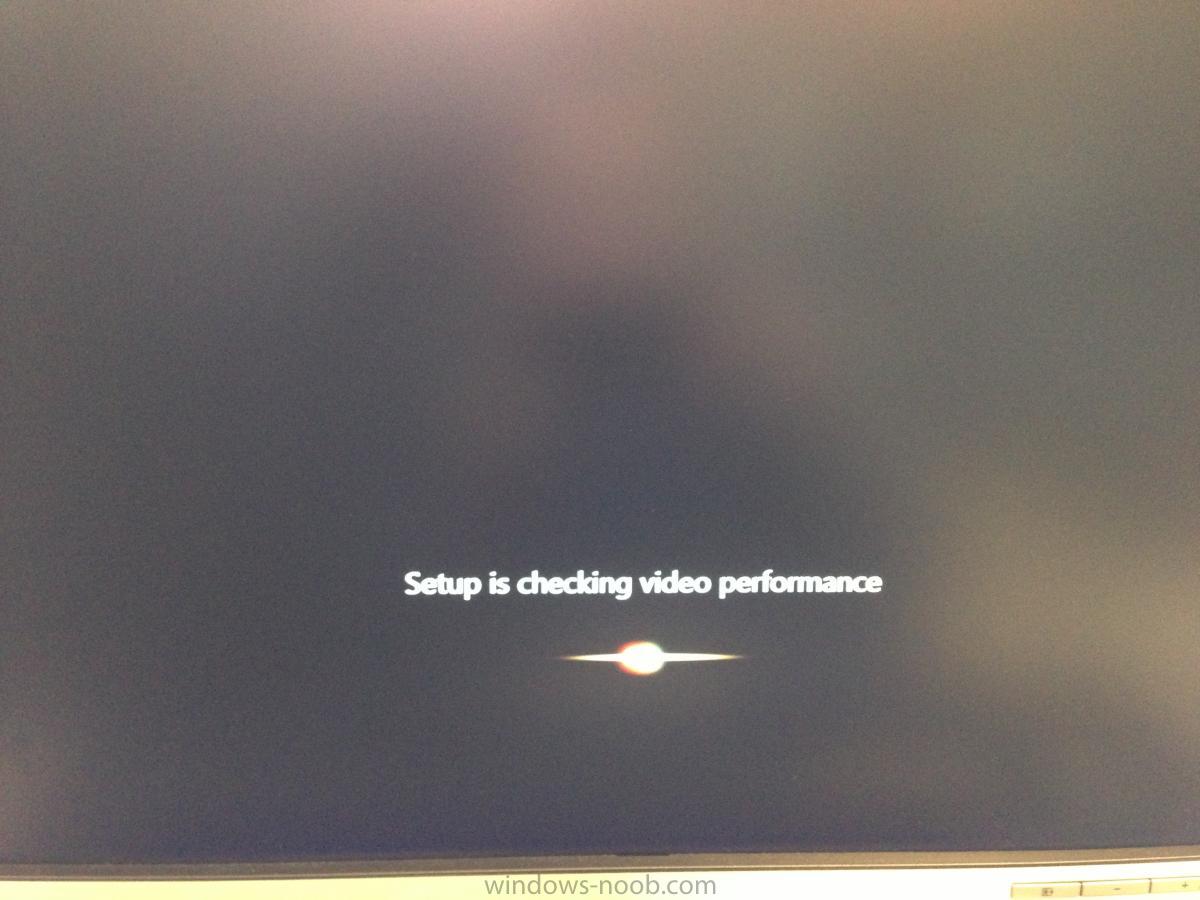

I'm trying to deploy Windows 7 with a couple applications and everything looks good up until the part it should be installing the applications. It completes and lets me log on with my domain account, but not with the local Administrator account, even though I configured the task sequence to enable that account and gave it a password. Once logged in, I see that no applications were installed and no Config Mgr client either. I see that it has given the hard drive label, OSDisk, Applyed Org Name, joined the domain and put the computer in the proper container, and has applied drivers. Most of the drivers as there are a couple that are missing.

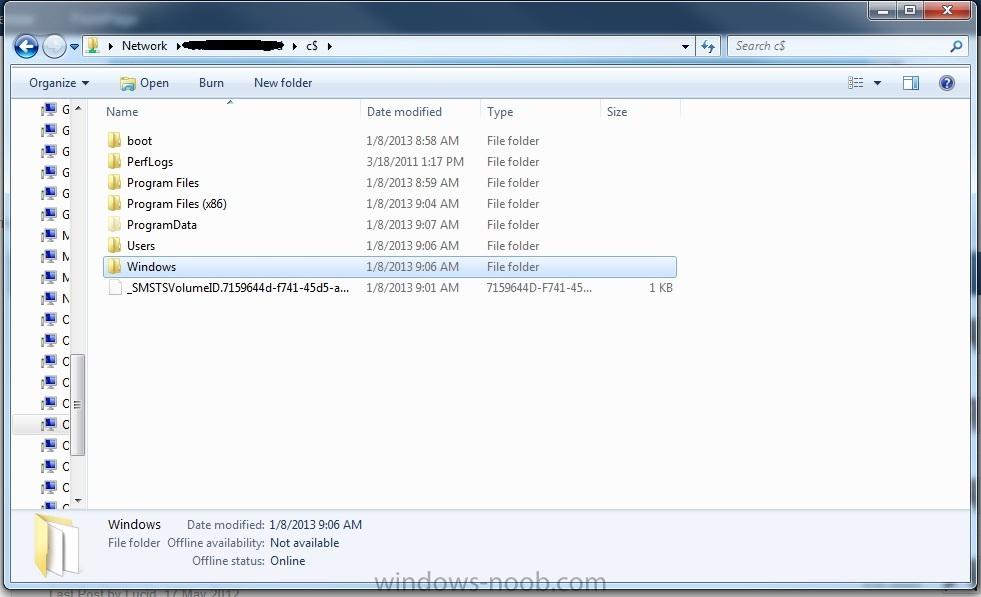

I'm not getting an error and I don't see any log files on the client; the only thing I see is a file in the root (_SMSTSVolumeID.xxxxxxxxx) and an empty folder named "boot".

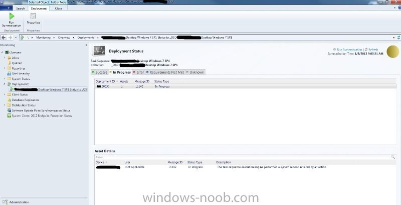

SCCM seems to think that the deployment is still in progress based on the deployment status " "
