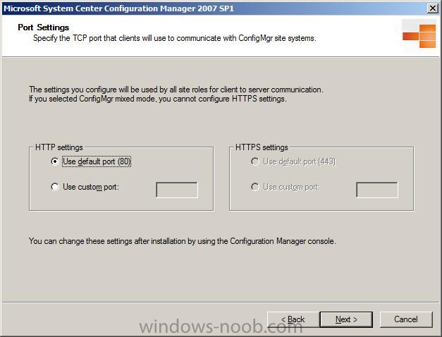

High Tower Posted June 1, 2009 Report post Posted June 1, 2009 i get The language specific BITS version wasn't found (Failed to download 'WindowsXP-KB923845-x86-ENU.exe' from 'http://SERVER.DOMAIN.LOCAL/CCM_Client/i386/BITS25' with error code 0x80004005) in ccmsetup.log on my client. the correct link however is http://SERVER.DOMAIN.LOCAL:200/CCM_Client/i386/BITS25 with port 200 which settings shoud i change to reflect this during my client push install process ? Quote Share this post Link to post Share on other sites More sharing options...

anyweb Posted June 1, 2009 Report post Posted June 1, 2009 where on your sccm server did you define it for port 200 ? Quote Share this post Link to post Share on other sites More sharing options...
High Tower Posted June 1, 2009 Report post Posted June 1, 2009 port 200 is configured in IIS by default SCCM uses port 80 ( i dont know where this is set - otherwise i wouldn't need to ask ) Quote Share this post Link to post Share on other sites More sharing options...
anyweb Posted June 1, 2009 Report post Posted June 1, 2009 the port is defined when you install SCCM as in this screenshot if you want to change it, then go into site settings and right click, choose properties, then ports as below Quote Share this post Link to post Share on other sites More sharing options...
High Tower Posted June 2, 2009 Report post Posted June 2, 2009 anyweb said: the port is defined when you install SCCM as in this screenshot if you want to change it, then go into site settings and right click, choose properties, then ports as below works when i put 200 as default port and open this port in windows firewall on site server. Thanks Quote Share this post Link to post Share on other sites More sharing options...
