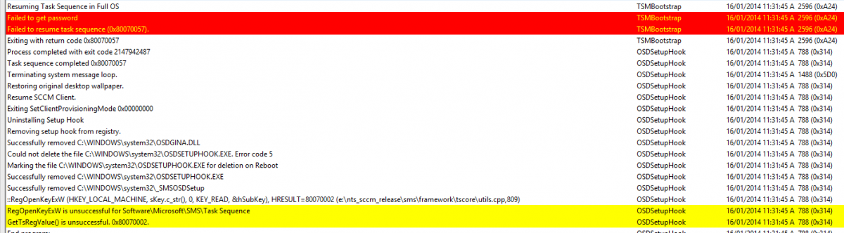

jaskelly3578 1 Report post Posted January 16, 2014 Hello all the experts out there. I have recently upgraded SCCM 2012 R2 and am now experiencing and issue with my task sequences not completing correctly. They all (Build, deploy, win7 and win8) get to the point where they install the client and then reboot straight into windows without installing updates or applications. Things I have checked: Boot image version is: 6.3.9600.16384 TS uses correct boot image TS is Newly created CM TS not MDT TS Network Account password I am using ADK 8.1 and MDT 2013 The smsts.log file has the strange error "Failed to get password, Failed to resume task sequence (0x80070057)" as seen in the attached. I am also sometimes getting this error as well "failed to register task sequence with the newly installed client" It also does not remove the _SMSTaskSequence folder created on C:\ Please help as this is driving me crazy Thanks in advance, Jason Quote Share this post Link to post Share on other sites

jaskelly3578 1 Report post Posted January 16, 2014 Hi Rocket Man, I have sorted the issue. The client upgrade that came with the one of the hotfix's was not being installed during the OSD. The was the smallest of errors in the PATCH=.................. command that i was using. Now this has been sorted the task sequence components have been upgraded and the error has disappeared. Thanks for you help. Quote Share this post Link to post Share on other sites
