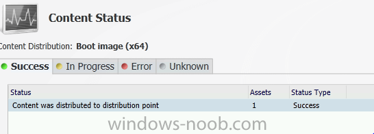

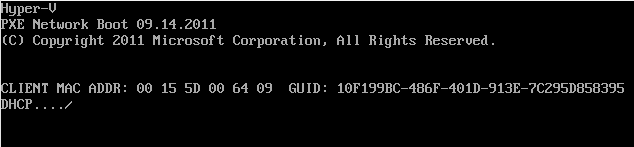

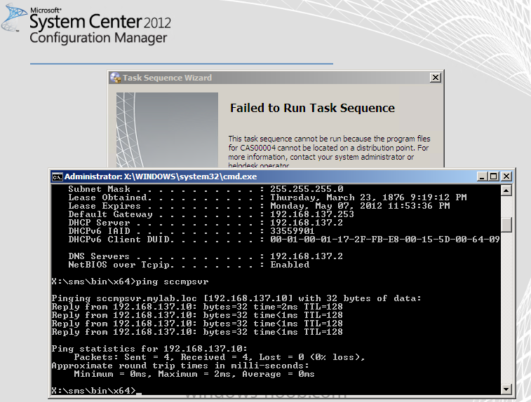

I have installed a hierarchy SCCM 2012 - CAS-PRI. PXE is enabled. Now, when I PXE boot a Hyper-V VM at first boots fine then goes upto Build and Capture TS selection. Once selected, next I see retrieving policy for this computer, resolving task sequence dependencies and then errors out (in smsts.log: 0x80040102). Attached are few screenshots and SMSts.log file. smsts.log Strange part of the PXE is once I remove computer from the Devices list so that I can retry but VM won't PXE boot until few mins (pic 4). Why? does SCCM takes time to clear out that unknown computer from the system?

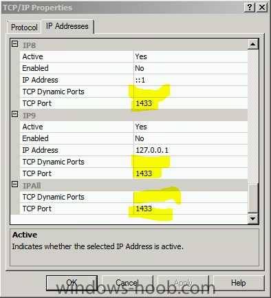

resolved: You do need to provide instance but in order for it to work you need to remove dynamic ports. restart sql service. entry see below: -

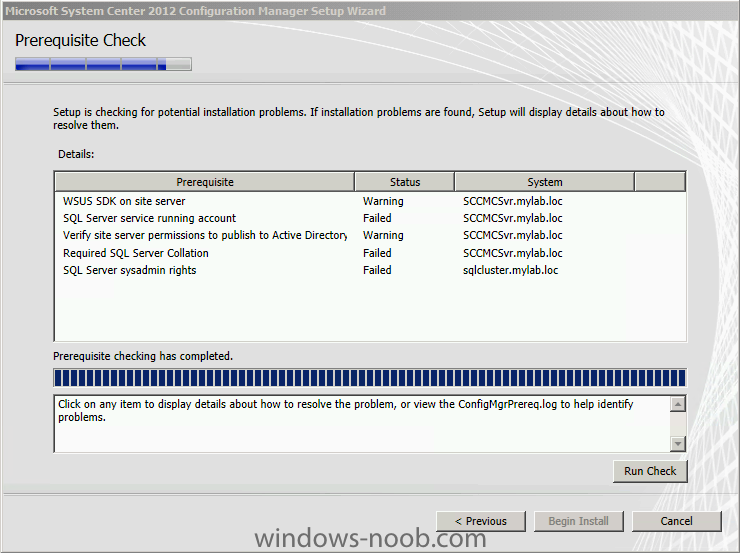

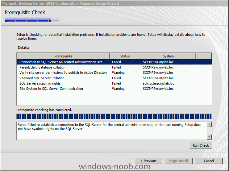

ConfigMgrPrereq.log What am I missing? Initially AD permission didn't show up but second run showed AD issue. Why? I did delegate again for system mgmt. container but this warning remains. -

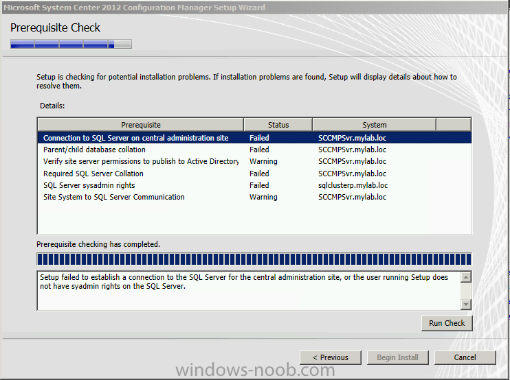

I have installed two node clustered SQL Server 2008 R2 with SP1 & CU4 updates on Windows Server 2008 R2. I have used SQLAdmin domain user (i know i should have installed with SCCMAdmin but our requirement is that I cannot use other than SQL service account). Per Part 1 document I have set firewall settings for TCP 1433 and 4022 via GPO. I have SCCMAdmin domain user trying to install SCCM 2012. Log shows: "creating sql connectionn to database sqlinstance\master on SQLclustername.mydomain.loc" and get a popup msg as "Setup is unable to connect to SQL Server with the connection information provided. Verify the following:" I have added SCCMSvrs (group which has all sccm computer accounts) and sccmadmins (group) to Local Administrators group in SQL nodes. Also, I have added SCCMAdmin account in SQL Instance as sysadmin. Still no go. Please help. Thanks

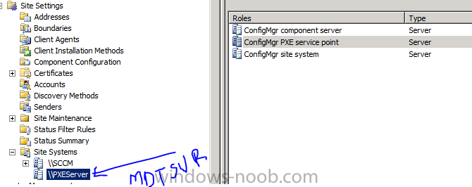

Mistake: i was typing PXEServer instead of MDTSvr which is actually the server name. Overlooked. All is well. -

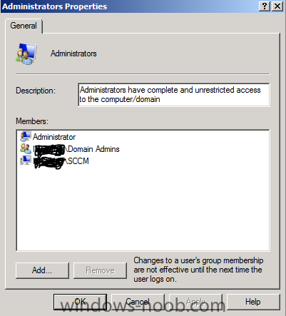

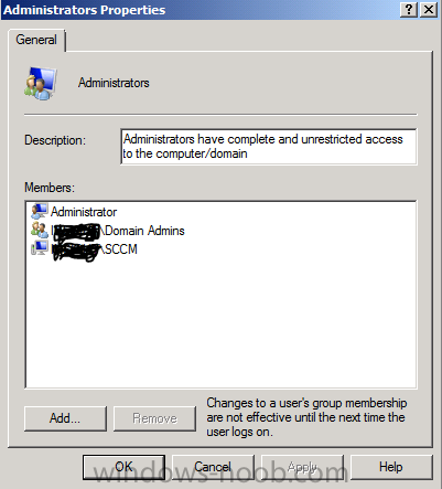

i have searched under domain admin on MDTSvr ... no pxesetup.log. i haven't checked sccm computer account access on MDTSvr therefore I think as you mentioned may not be able to install PSP. But wouldn't there be a log somewhere to say that? Update: Added SCCM computer account in MDTSvr Administrators group but still no go. Here's the screenshot: (I did delete PSP then deleted PXEServer from the node and then re-added the server.) Thanks -

No, as mentioned in my initial post that PXE server (MDTSvr) is not visible or listed. -

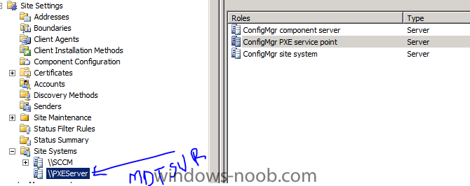

kris00l posted a question in Troubleshooting, Tools, Hints and Tips
I have installed MDT Server with WDS on it and able to do Lite touch installations. DHCP Server has 60 N/A due to different server than WDS 66 no entry 67 no entry Now, I have installed SCCM on a different server in the hope for ZTI. After reading many blogs I found out that PSP needs to be installed on WDS Server. Therefore I went ahead with that process: Under Site Settings, right clicked Site Systems Clicked NEW, Server Called PXEServer (made up name), FQDN - mdtsvr.mydomain.loc checked PSP role finish PXESetup.log on SCCM server - no changes Event viewer on SCCM server - nothing related to PSP Under, boot image, Manage DP doesn't show PXE$ either. I have also tried, uninstalled WDS role and reinstalled with no configuration. Deleted PSP role and then deleted PXEServer. Recreated again. Still NO go. Please help. Thanks
