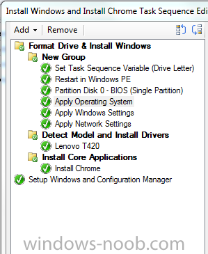

We want to install our core programs during the OSD task sequence. Everything works fine with loading applying the Windows .wim image, detecting the hardware and installing the correct driver package. However, whenever I try to install a package, either nothing happens and the machine boots to the Windows login screen, or I get an 0x00000032 error. I've attached logs, as well as a screencap of how my task sequence is laid out. I'm really hoping to get this issue squared away so that I can really get moving on efficiently imaging all of our machines. Thanks so much in advance for any help! smsts.log smsts-20130314-101623.log
