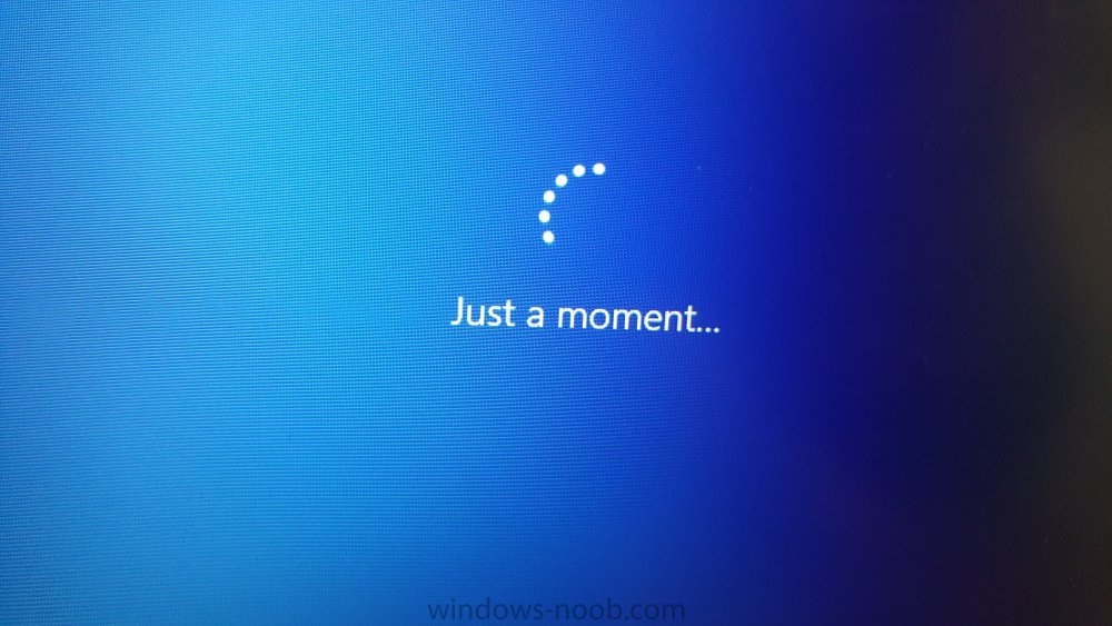

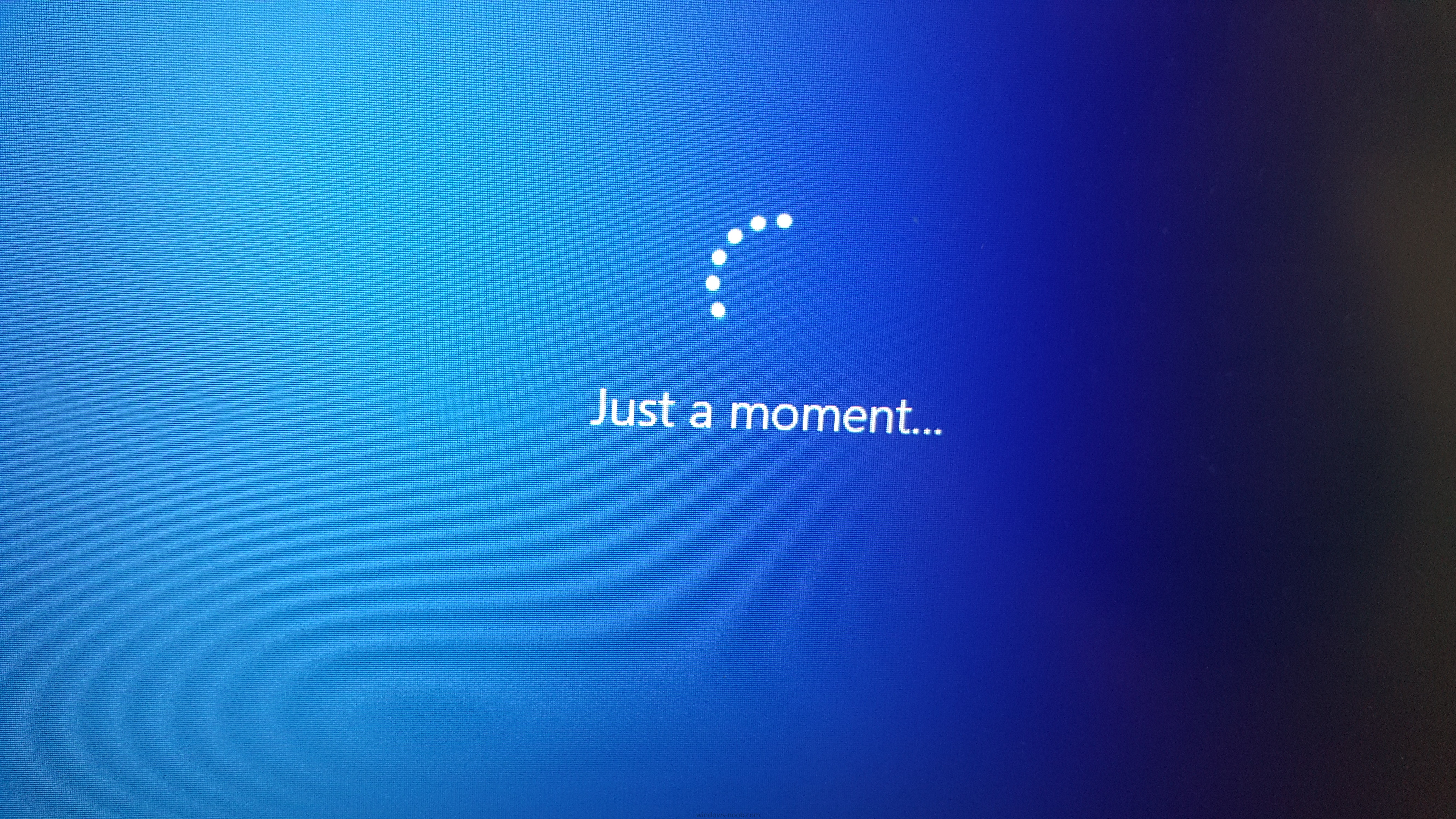

Hey guys sorry for the delay. I found the problem in our environment! It turns out that deleing the account DefaultAccount was causing it to lock up...for what reason I just don't know. We disabled this step and our workgroup based Task Sequences are now working properly. I have a gut feeling that Microsoft are now using this built in account for other things where as it was just an erroneous in the past.

Hey guys this issue has been driving me crazy the last week or so. It seems work fine with our Win10x64 1703 Domain Task Sequence but not our Win10x64 1703 Workgroup Task Sequence (it stays at Just a sec forever). We are ConfigMgr 1702, ADK 1607. It does kinda have a OOBE feeling to it and I have tweaked a couple of settings such as SkipMachineOOBE but not getting anywhere! I have a feeling that there is either a patch or something like that in my build or a bug with the ADK? Does anyone else have some suggestions?
