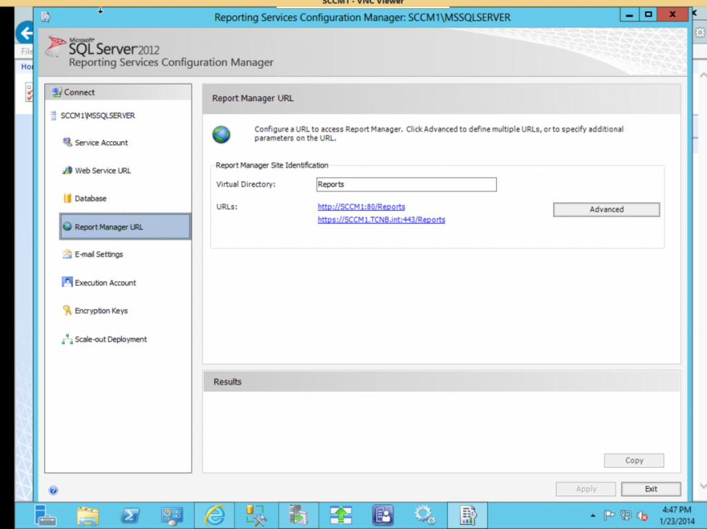

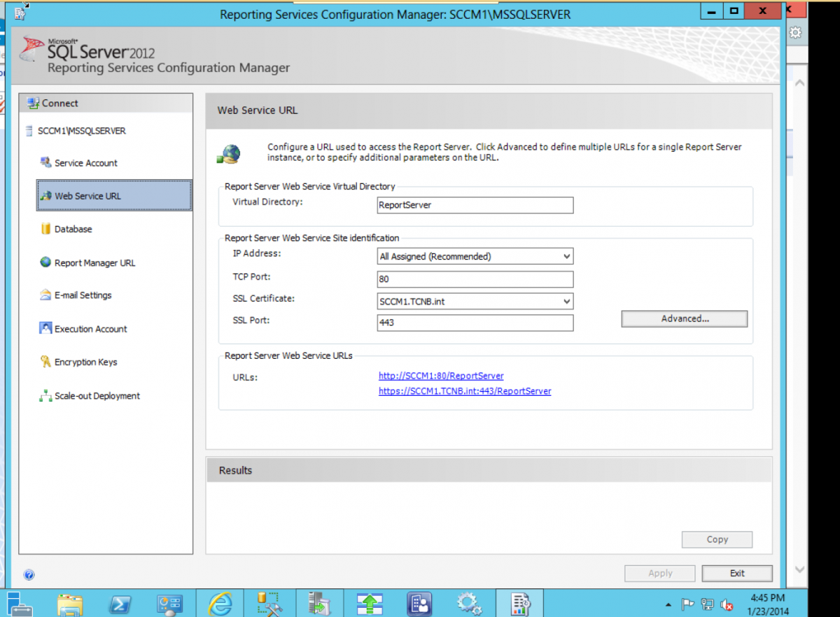

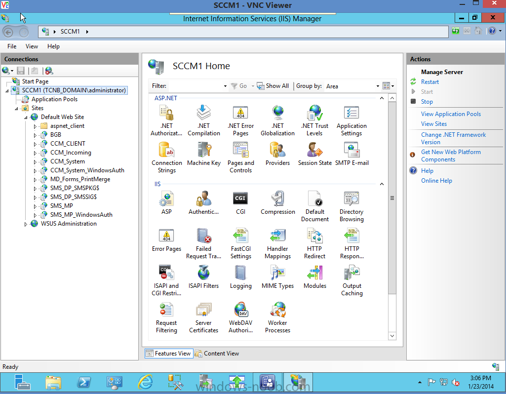

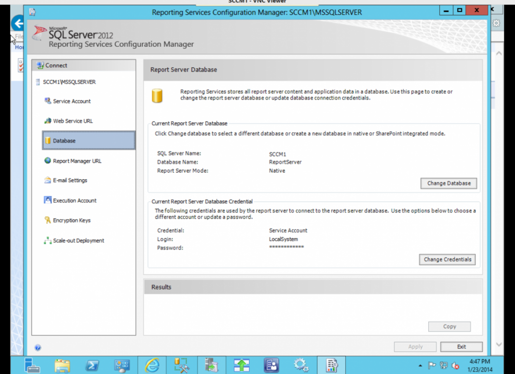

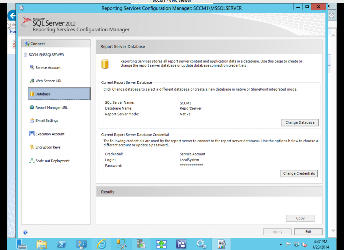

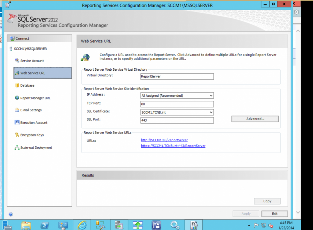

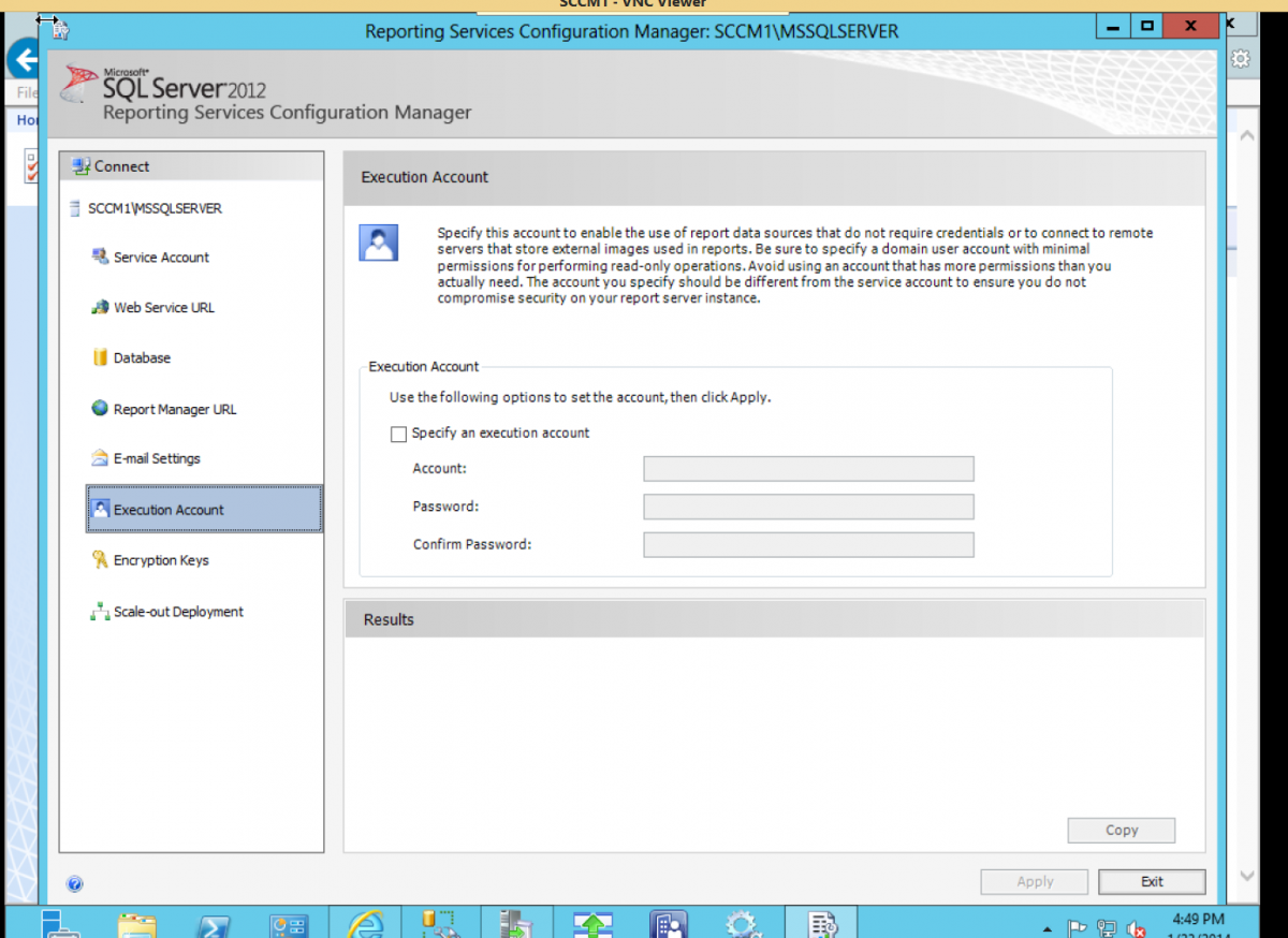

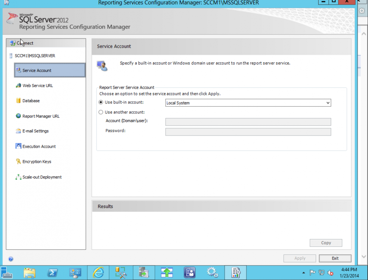

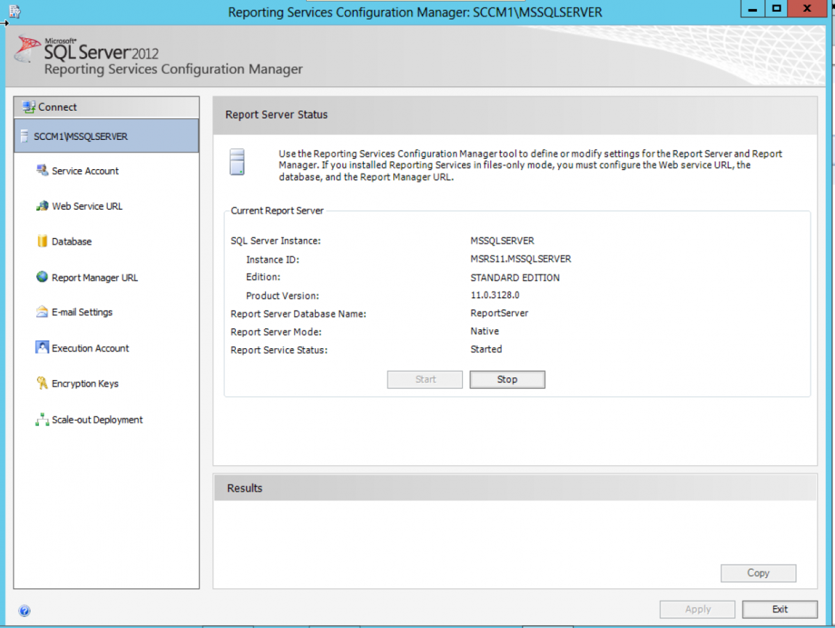

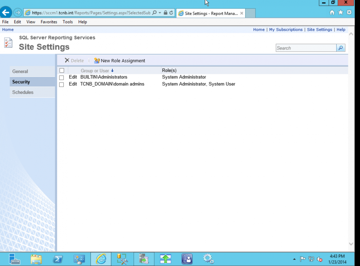

  1. I checked the firewall and I even made another rule to allow inbound on ports 80 and 443. Yes we are running it all on one server. I think the problem may be with IIS but I'm not sure.

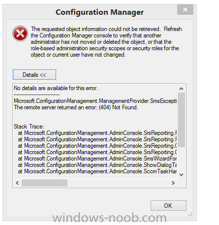

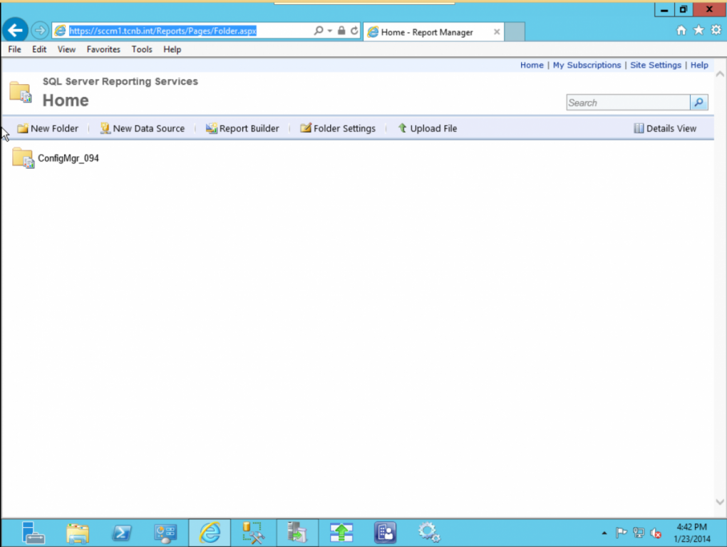

  2. Don't know if this helps but I also cannot access the native web interface from my workstation but I can from the sccm server. When I try to go there I get a 404 error.

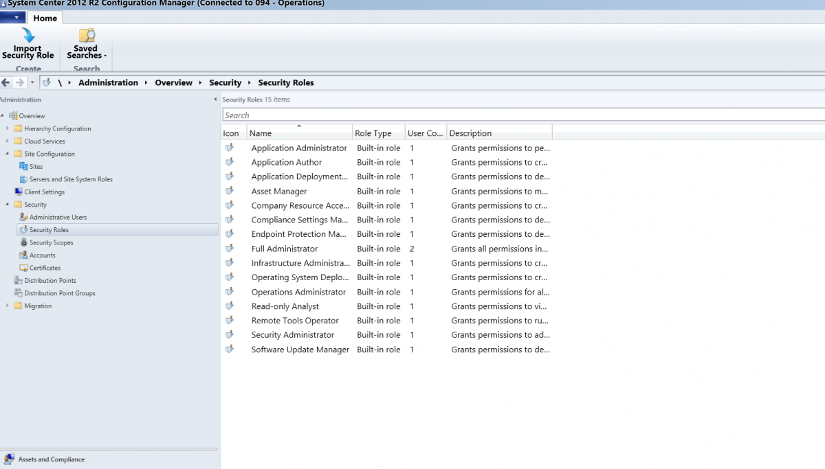

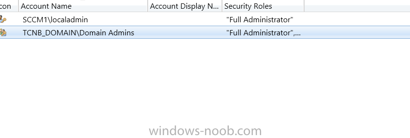

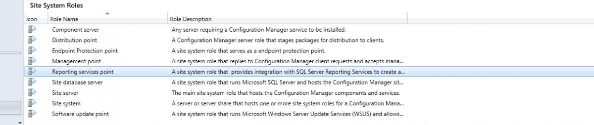

  3. I've already imported the trustedpeople certificate from the sccm server. I also verified that the domain admins group is a full administrator. I added the reporting services point and readded a second time. One thing is that I do not see the reporting services role. In the security roles tab.
  4. This is what I get when I try and create a report from my workstation.

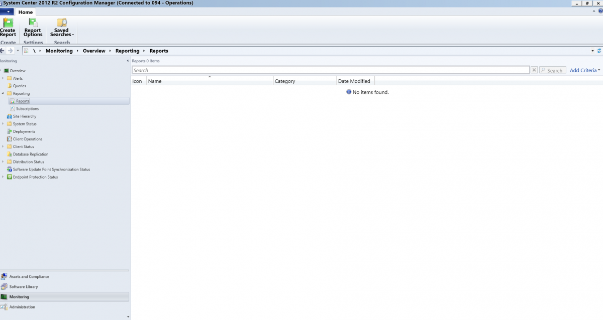

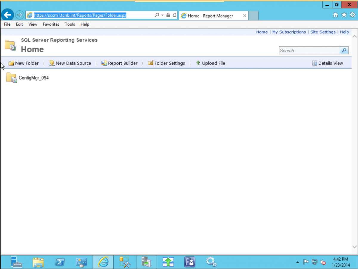

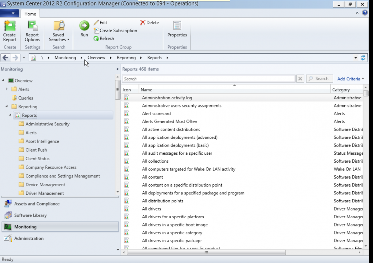

  5. Hello All. I have a little issue with reports not showing up on my admin console. Odd thing is that when I log into the SCCM server the reports are visible and can be run without issue. How can I get the reports to show up in my admin console. I have included screen shots. The first is the server and the second is my admin console. Any help would be a great help. Thanks in advance.
