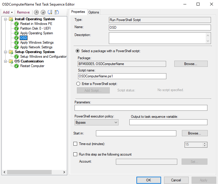

I have the following in a PS script but the TS fails. [string] $MacAddress = Get-WmiObject Win32_networkadapterconfiguration | where {$_.ipenabled -match "True"} | select -ExpandProperty MacAddress | select -First 1 [string[]]$TextFiles = Get-Content \\fileshare\*.txt foreach ($element in $TextFiles){ [string[]]$TextFilesSplit = $element.Split("=") [string]$MacFromArray = $TextFilesSplit[0] [string]$ComputerNameFromArray = $TextFilesSplit[1] $MacFromArray = $MacFromArray.Trim(" ") $ComputerNameFromArray = $ComputerNameFromArray.Trim(" ") if($MacAddress -eq $MacFromArray){ $OSDComputerName = $ComputerNamefromArray } { $TSEnv = New-Object -COMObject Microsoft.SMS.TSEnvironment $TSEnv.Value("OSDComputerName") = "$OSDComputerName" } This is what the log file says Running powershell script: 'OSDComputerName.ps1'(PkgID: BFM000E5) with execution policy: 'Bypass' RunPowerShellScript 2019-08-23 09:11:47 2788 (0x0AE4) Filesystem::File::Exists( sPowerShellPath.c_str() ) == true, HRESULT=80070490 (main.cpp,345) RunPowerShellScript 2019-08-23 09:11:47 2788 (0x0AE4) PowerShell.exe does not exist at 'X:\WINDOWS\system32\windowspowershell\v1.0\powershell.exe' RunPowerShellScript 2019-08-23 09:11:47 2788 (0x0AE4) ExecutePowerShellScript(sScriptName, sParameters, sPackageID, sExecutionPolicy, sOutputVariableName, dwPSRunExitCode), HRESULT=80070490 (main.cpp,876) RunPowerShellScript 2019-08-23 09:11:47 2788 (0x0AE4) Run PowerShell script failed to run, hr=0x80070490 RunPowerShellScript 2019-08-23 09:11:47 2788 (0x0AE4) Process completed with exit code 2147943568 TSManager 2019-08-23 09:11:47 1040 (0x0410) And I'm trying to run it like the attached.

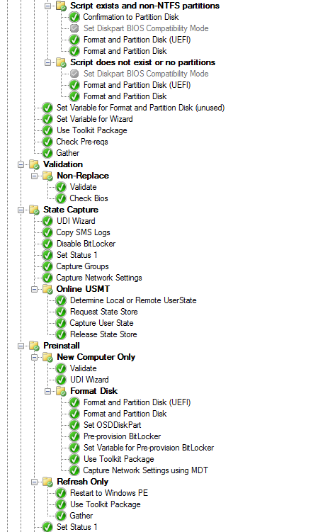

I did something now which made it work, not entirely sure how to correct this in the TS. When I booted F12, I used DiskPart to list disk, I cleaned it and created a partition. The deployment was successful after that. So it seems that the TS isn't partitioning the disk the way it should? What can I look at? -

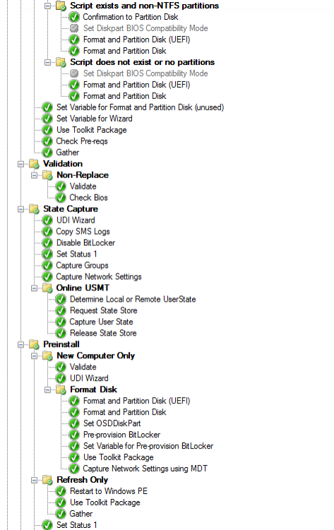

[H] SCCM and OS Deployment
Joe13 replied to Joe13's topic in System Center Configuration Manager (Current Branch)
Can someone shed some light on my new issue. I have 1 testing PC where everything works fine, any other PC fails with the same error, new or used PC. There are no more volumes available for use. ApplyOperatingSystem 2019-03-19 15:25:07 1780 (0x06F4) The requested target could not be resolved to a valid volume on this computer. Check your task sequence to ensure this drive is correct and that it is being created The parameter is incorrect. (Error: 80070057; Source: Windows) ApplyOperatingSystem 2019-03-19 15:25:07 1780 (0x06F4) Failed to run the action: Apply Operating System. Unspecified error (Error: 80004005; Source: Windows) TSManager 2019-03-19 15:25:07 1656 (0x0678) Attached is the first step of my TS where it fails. -

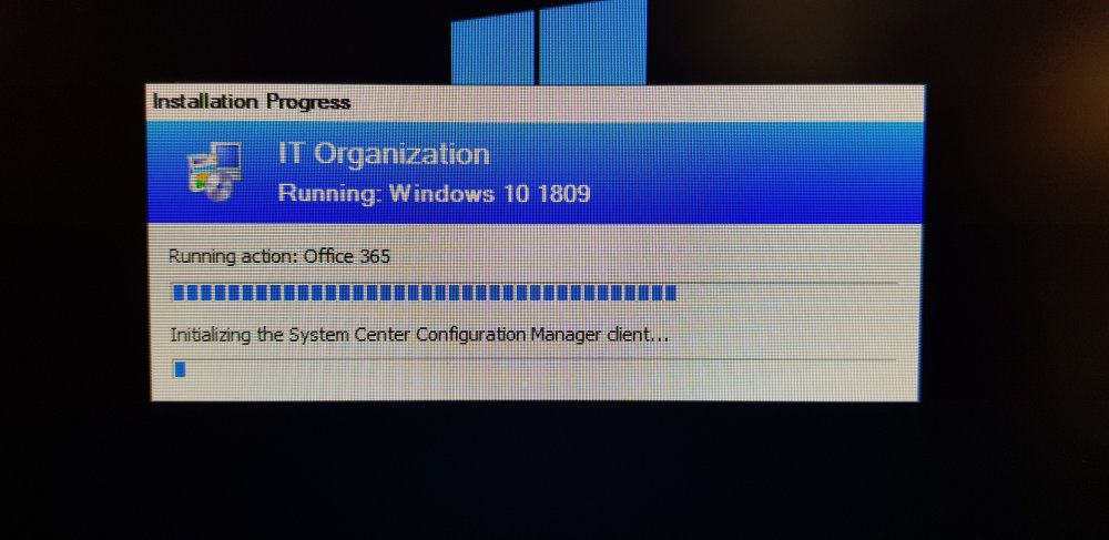

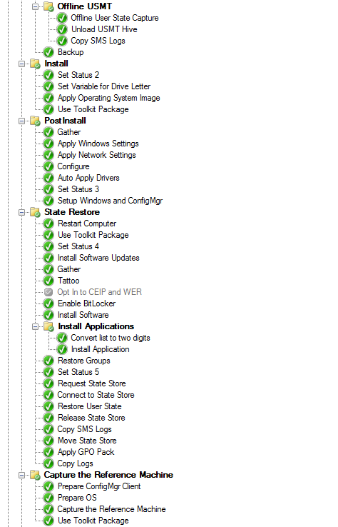

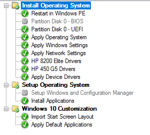

See screenshot, when I add a step in TS to install software after the built in "Setup Windows and Configuration Manager" It proceeds past this step, by when it gets to install software on the bottom it shows Initializing SCCM client. Is this correct? I added restart commands between these steps. My software installs, when Windows is done the are no apps installed? It just wouldn't install, If I deploy the apps to a collection and install it from Software Center it works. Just not in the TS. Also added restart steps between app installs. -

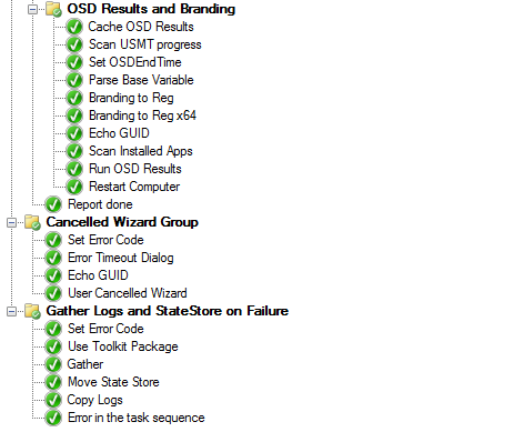

This post forms part of option 3 and 6 of my OP. How can I make this TS lightweight, what steps can be disabled from screenshots attached? Do I use DISM to capture a custom image with drivers and software on it or how can I do this? Is it better to include the drivers with DISM or with this TS? Would it be possible to customize start menu tiles and shortcuts to my preference? -
