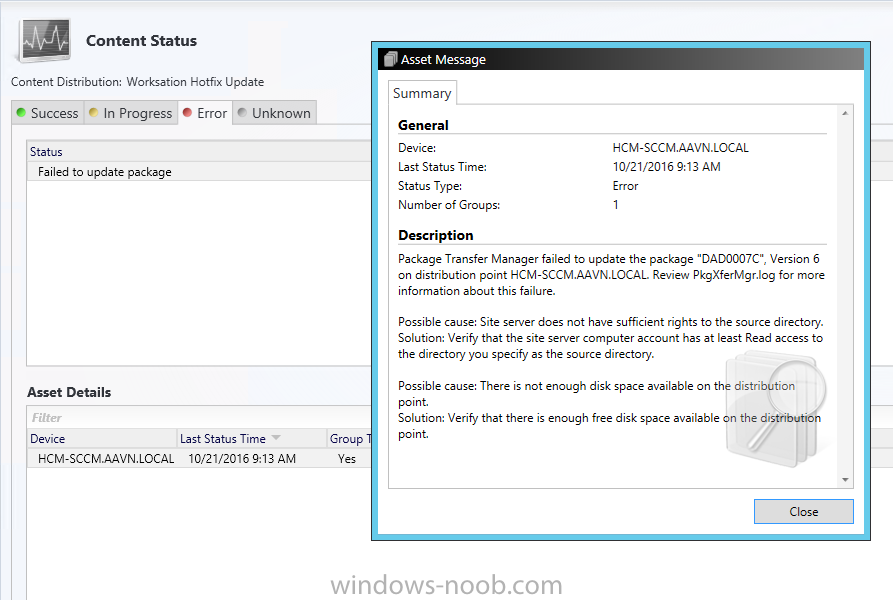

Hi everyone, I have a update hotfix package name "Workstation Hotfix Update", the capacity is around 9GB. When I distribute it to remote DP(HCM-SCCM), it keep error, pls have a look the attach file below I also try to reinstall DP role, the free disk in remote DP still available, another packages I still distribute ok. please help me to solve this issue Thanks. PkgXferMgr.log

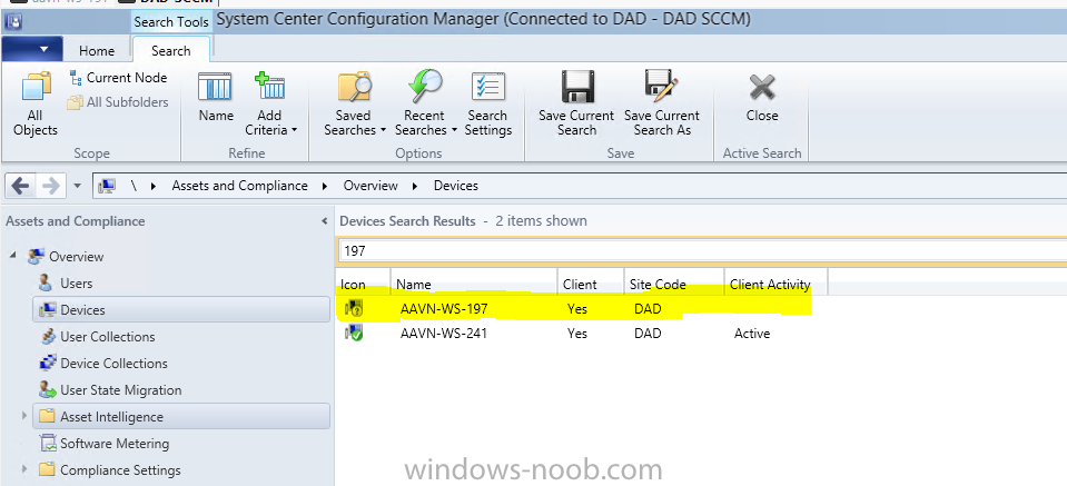

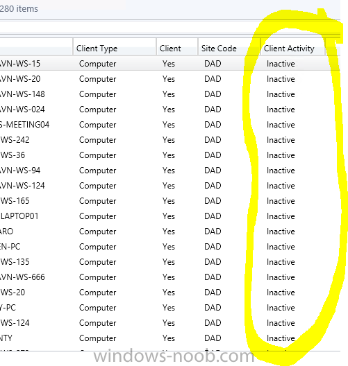

I just found out that many PCs in our system has been inactive in SCCM, at least half of all computers. I tried to reinstall agent, check client log, but did not find any idea. Can you please advise me how to solve and what I need to check in boundary? -

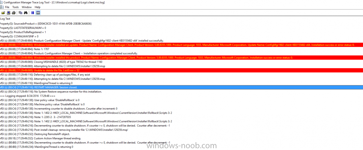

yes, because I check in SCCM device, client activity fied still not active. Even in client, I did not see software center . I try to turn off antivirus, firewall, but no luck. In ccmsetup.log, I saw sccmsetup is exiting with return code 7, I guess there is a problem I attached full logs, please feel free to have a look. ccmsetup.log client.msi.log -
Hi everyone, Some PCs in my company failed to install SCCM client. There is a error in client.msi.log, tried to research but can not find a way to solve, please advice me how to solve it Thanks you.
