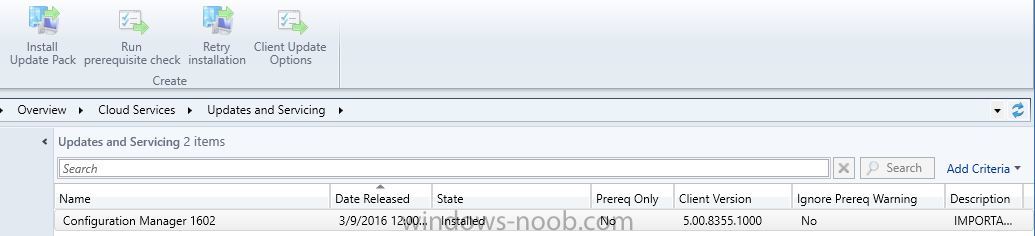

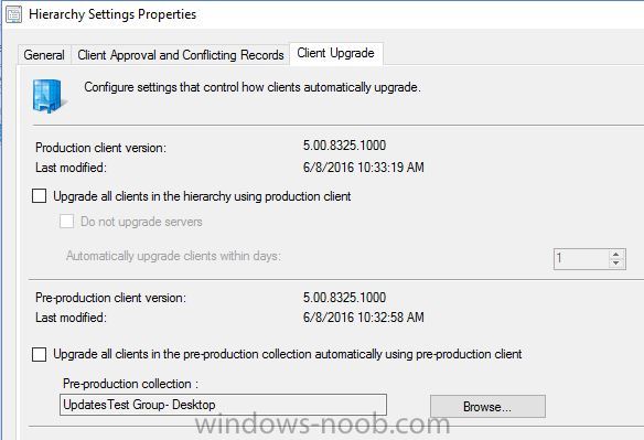

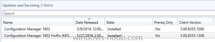

  4. I have a single site server that was running 2012 R2 SP1 that I recently upgraded to the 1511 build, then used the in-console upgrade to bring up to the 1602 build. When I performed the upgrade to 1602 I chose to validate the client in a pre-production collection. The client upgrade worked fine and my test systems showed that they had the 5.00.8355.1000 client installed. The "Client Upgrade" tab from the "Hierarchy Settings" properties showed the Production Client version as 5.00.8325.100 and the pre-production Client version as 5.00.8355.1000. So far so good... Then I tried to promote the new client to production but the "Client Update Options" was greyed out. I tried installing the "Configuration Manager 1602 Hotfix (KB3155482) to see if that helped with my problem but it got a little weird. During the install I chose to just update the production client without validating, but when I checked the "Hierarchy Settings" it showed both clients as back to 5.00.8325.1000. I'm not really sure where to even start trying to troubleshoot this. Any advice? Thanks
