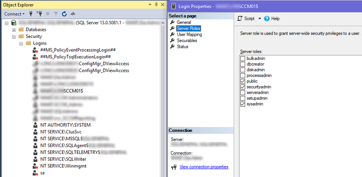

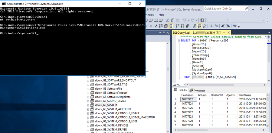

Yes, thanks Garth; I've read all that, and am taking it into account. As mentioned, I also followed your guide here: https://www.enhansoft.com/updated-how-to-create-a-sql-server-computer-account-login/, and it was already configured like that: I ran the test as you described, and it was successful (the below test was performed on the site server): As far as I understand, it's not the site server's account that's having a problem. NT AUTHORITY\SYSTEM is the local system account on the (separate) SQL server, isn't it? If it were the site server, the errors would show as <computer name>$, wouldn't they?
Well, I wanted to double-check my previous experiment, so again, I mapped "NT AUTHORITY\SYSTEM" to the SCCM database, and gave it db_owner role membership. The permissions on the reports now look fine, and users can access them as expected. But I don't see this as a solution, as doing this isn't mentioned in any documentation or guides, so there must be an underlying problem. And I've also read that it's not a good idea, from a security standpoint. As for SW inv, I've traced it through all the logs I know of, and it seems to be going through the steps it's supposed to, without errors. But the reports are still empty, including the "All inventoried files..." ones. Thanks.

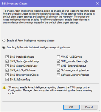

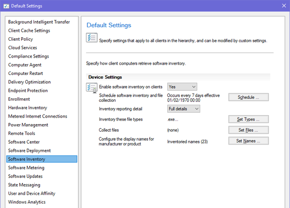

Thanks for that, Garth. I was aware of the issues around software inventory, but I think your posts have finally persuaded me to turn it off. However, before I do that, I want to figure out why these tables aren't being populated, and why the permissions seem screwy. I agree that inventorying .exe is rather excessive, but I was trying to mirror the settings on the old server (set up long before my time), which was working perfectly well. Oh and sorry for the misunderstanding; I didn't mean I'd configured it just now. I meant "simply". It's been like that since about October last year. Anyway I'm thinking more and more that this is a fault, and not that I've mis-configured something, so I'm going to try re-installing the reporting point, to see if that fixes it. After that, it's a call to Microsoft. Thanks for your help!
Yup, I just configured it to inventory .exe on all client hard disks, including subfolders, excluding "Windows,Compressed". And I think it's unhealthy because on our old 2012 R2 site (which is still active, but has no clients), those same reports produce hundreds of records. As far as I can tell, they're both (the 1810 site and 2012 R2 site) configured the same, as far as SW inventory goes, but the new one produces just one record. And in addition, as I alluded to previously, when I gave NT AUTHORITY\SYSTEM the sysadmin role on the (1810) site database, that report suddenly starting showing lots of records. So I think that somewhere, the permissions are wrong. Besides that, there's the fact that users aren't getting access to reports, as I believe they should. Thanks.
Indeed. As far as I know, I've configured everything required for those reports to work. I suppose I could stick to ARP reports, as you say. I just don't like to leave anything in less than 100% health. Thanks a lot for your advice, Garth. I tried giving NT AUTHORITY/SYSTEM the sysadmin role on the SCCM database, and that seemed to get everything working. But I haven't seen that in any of the documentation or guides I've read, which makes me think that something's just not right. And I've also seen it suggested that it's not good from a security standpoint, so I don't want to leave it like that. There's definitely something wrong with my setup, so it would be good to get to the bottom of it.
