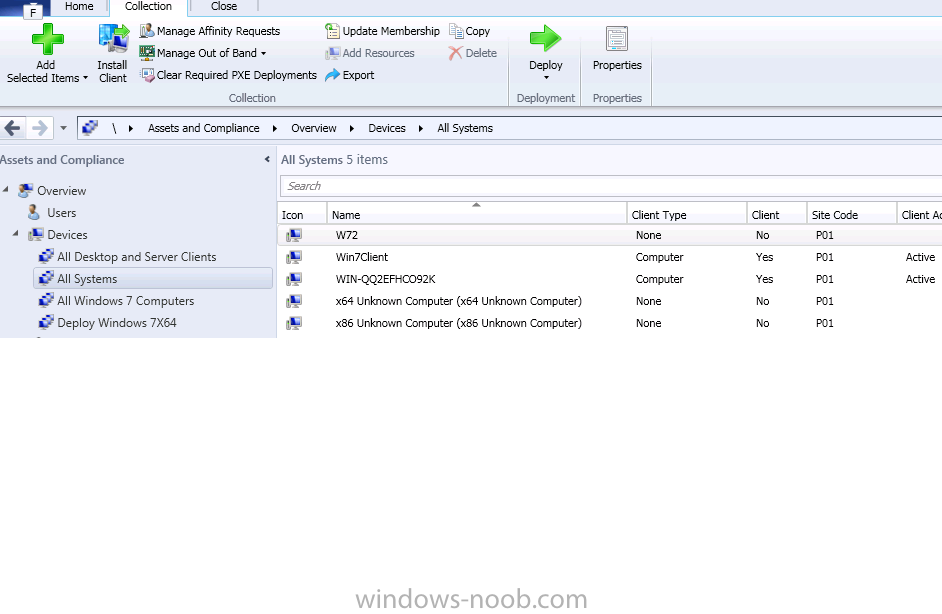

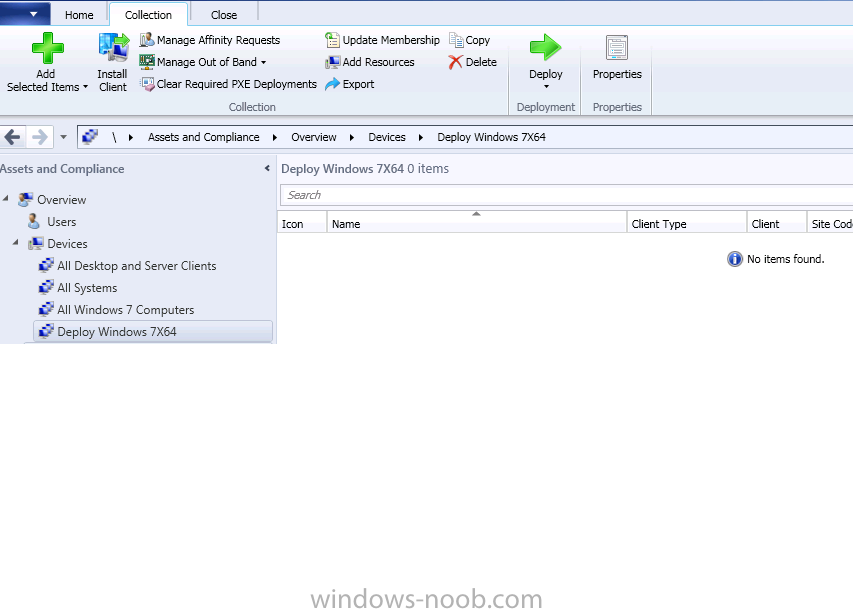

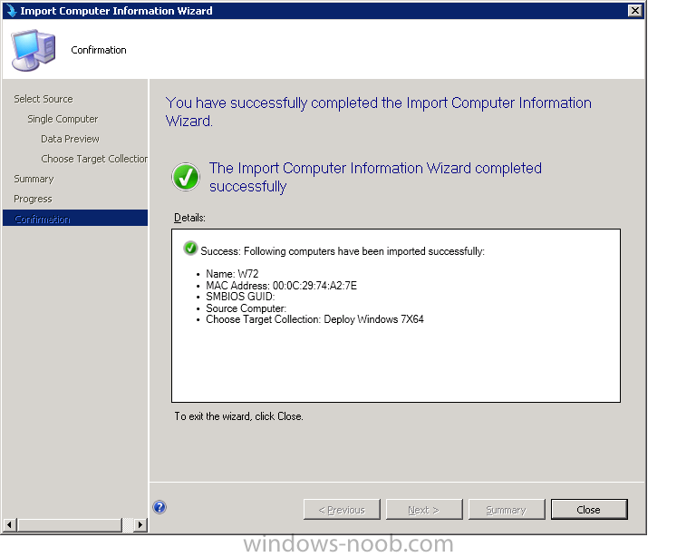

I got stuck on a Step 6. I added a new workstation as a single computer. And able to see it in "All systems". A new VM without any OS installed. However it was not added to a "Deploy windows 7X64" collection. I am trying to add it manually by right clicking the client /Add Selected Item/Add Selected Items to Existing Device Collection. When i go back to the collection i see "No items Found." What am i missing? Thank you.
