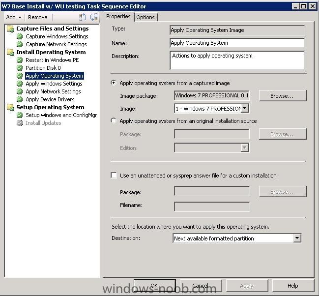

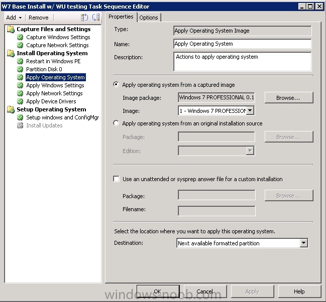

0x80070002 error during TS step: Applying Operating System
EvolutionXtinct replied to EvolutionXtinct's question in Deploy 7
I took a stab at it today... Not sure if i'll throw the server or hug it... But I went in and did a net use and connected Q:\ directly to the package folder that is shared \\sccm1.......\smspkge$\cr100021 and without entering a username/password for net use it says "The password is invalid for \\sccm1.......\cr100021" I tried doing a net use on my local PC and I get the same thing. Is there a awy to see what username the WinPE users to connect to shares? I know nothing has changed the NAA user is unlocked has its password set to never expire and never change password. I talked to the server admin he says network/service accounts are never changed and thats part of there process for the environment. We both looked at the SCCM server, verified share permissions are set to unlimited and only seen the 1 concurrent connection I created manually to the share. I'm not setting the NAA account to Domain Admin access to see if it changes anything. I went through and recreated EVERYTHING, I recreated the Boot Image and pushed it to my DP which is the main SCCM server (we only have 1 site, 1 SCCM server, and 2 remote DP's for low speed network segments). I had it re setup the .WIM file for installation which SCCM took with no problem. Those are both out on the DP's. Is there some service (besides MS we can pay) to have them troubleshoot this for us? -

K i've looked all over Google and everything points to a NAA being needed. But I verified there is a NAA account i've set taht account with FULL PERMISSION to the whole Package Drive E: where all packages are stored. I've verifed I can have regular packages run just fine its ONLY WHEN THE SYSTEM reboots does this issue happen, I can install Flash and Office 2010 no problem to these test machines. Can someone give some insight.... What I don't get is this was working only about 2 weeks ago, then I started working on WU being pushed through RAP which I got that working, decided to go back to my OSD and start making WU work with it and now my whole deployment is screwed. How can this happen???? -

I'm not sure what is going on now. I allowed the network access account full access to the drive where all packages are stored and nothing has changed. Anyone else got any ideas on why I would be getting those permission errors? I'm able to deploy the package, it restarts in WinPE but when it goes to apply the OS it then has this permission error. How is this even possible when it downloads the WinPE package? Sadly the company who set this up isn't available till May to assist us on deployment, and I would really like to get this accomplished before that time. -

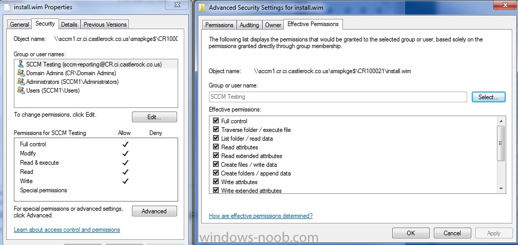

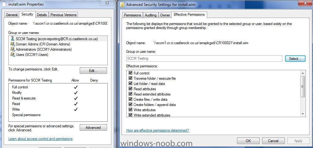

EvolutionXtinct posted a question in Deploy 7
Not sure why but when my OSD TS does a reboot into WinPE, it goes and formats the HDD, and it starts to download the Windows Image .WIM file and I get access denied errors. I looked at the permissions for the share folder and it looks correct. I can connect to my computer using its DNS name and to SCCM and copy over the SMSTS.log file. The screenshot "permission.jpg" is the permissions as well as the user I use to activate the TS to start. If someone can help that would be great.... smsts.log wpeinit.log -
