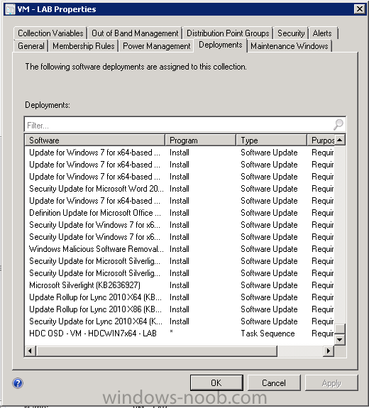

Thanks Peter for responding. I examined the collection structure and we did have nested sub-collections in our old cm2007 box. Thinking that the software update group would have trouble hitting the collection that the device to be imaged resided in, I created a test collection with a flat hierarchy and confirmed that the task sequence and software update group objects were indeed listed in the properties (see screengrab). I then re-ran the osd TS and software updates step still failed to execute with same error code as I noted earlier. This time though I scrutinized other log files in C:\windows\ccm\logs. I noticed in the UpdatesDeployment.log that the GUID for the corresponding software update group was detected. To me, something is rejecting the bits from the update package to be downloaded. Logs.zip WindowsUpdate.log
