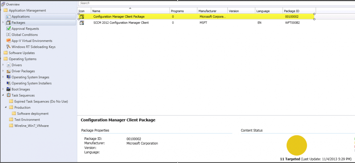

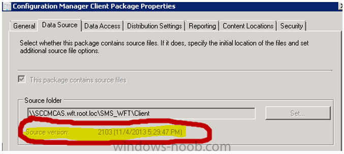

  1. Hi guys, I have come up with another issue that I have discovered and I have no Idea how this happen or how to resolve it. I actually have a case open with MSFT and it has been two days and they seem to be stuck on this. I notice that the Client Package that was created during the SCCM build is constantly updating. I have image of what i'm talking about below: I know the source version should not be that high and the client should not be updating constantly, seem to be every 4hrs or less its updating. What I have highlighted is the original package that was created during the SCCM build and the one below "SCCM 2012 Configuration Manager Client" is what I created manually which is working and not having a constant update. Thanks,
