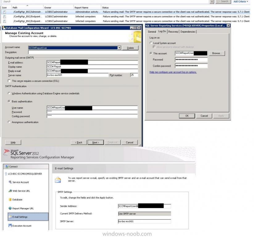

To summarise, I've created a report subscription which constantly fails with the Client was not authenticated, here's what I have done to try and resolve this issue:
  • SCCM - Email Notification Component is configured correctly. The SMTP test works and I also receive alerts when one of my SCEP rules are triggered.
  • SQL Management Studio - DataBase Mail is configured; sending a test e-mail works. Using Basic Authentication with a network account specified.
  • Exchange 2010 has a Receiver Connector created to relay e-mails from the SCCM Server.
  • Reporting Services Configuration Manager - Email Section has been completed.
  • The SSRS Service is using a domain account with has an associated e-mail address and mailbox.
  • Tried using anonymous authentication set on the Database Mail and also on the Exchange Receiver Connector - this actually stops Database Mail from from working.
I'm under the impression that if SSRS can send out test e-mails successfully, then SCCM should also work, as SCCM just uses SSRS to fire off those reports i'm subscribing to?
I've attached the screenshots of the various configurations within SCCM and also SQL 2012.
I've been bashing my head on this one for hours without any progress, so any advice is welcome!

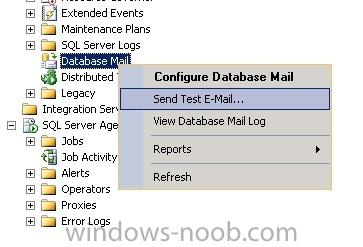

I actioned the "Send Test E-mail" option when you right-click on the Database Mail option within SQL2012. However, as you pointed out already, if this has absolutely nothing to do with the Subscription Reports configuration, then this is no longer relevant. If anything it just proves that e-mails can be sent via the Exchange server (using basic authentication).
Now, I guess, I just need to figure what within SSRS Configuration Manager is missing, my trouble is that there isn't any detailed settings I can configure and Exchange logs doesn't indicate anything that isn't already reported by SCCM:
2014-06-25T14:09:14.168Z,Exchange\SCCM01 - Subscription Reports Receiver,08D15B57A7508DA3,21,10.2.2.202:25,10.2.2.213:63905,>,530 5.7.1 Client was not authenticated,
