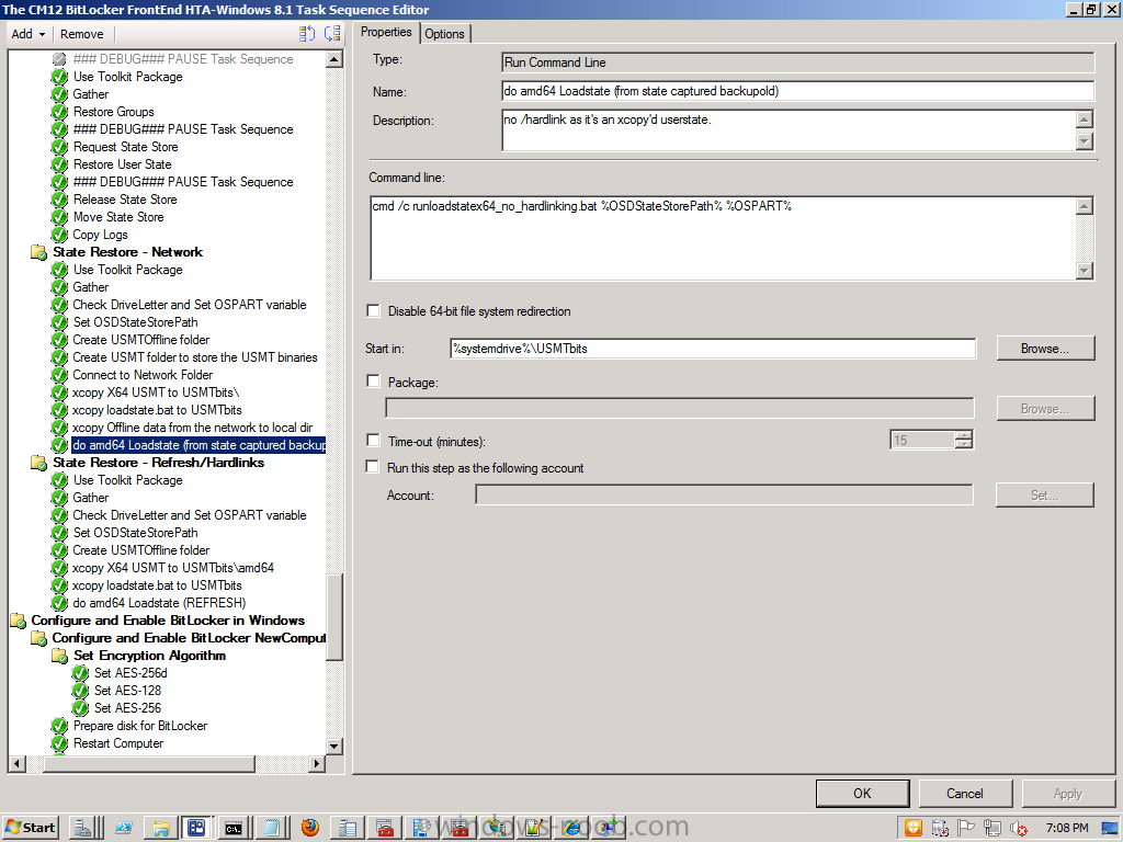

in addition, you can simply add a /lac statement like in the following batch file below
@set USMT_WORKING_DIR=%~2%\USMTbits\amd64
"%~2\USMTbits\amd64\loadstate.exe" "%~1" /c /lac:Password123 /i:%~2\USMTbits\amd64\miguser.xml /i:%~2\USMTbits\amd64\migapp.xml /i:%~2\USMTbits\amd64\wallpaper.xml /i:%~2\USMTbits\amd64\printers.xml /nocompress /v:13 /l:%~2\Windows\CCM\logs\SMSTSLog\loadstate.log
the variables used above (%~1 and %~2 are as follows)
if you dont want to use a batch file then modify the statements in your task sequence to match the above (more or less) and you'll be ok, the restore and backup parts of the above are all in the CM12 BitLocker Frontend HTA code available for download here
http://www.windows-noob.com/forums/index.php?/topic/7294-the-cm12-bitlocker-frontend-hta/
why reinvent the wheel ;-)
