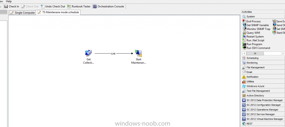

I have a collection of terminal servers that get restarted weekly early Sunday morning, so I created the group in SCCM (for the purpose of testing I just have one in it right now). I need to put this collection into Maintenance mode. I have configured the following run book, but I'm struggling with trying to figure out the correct syntax for the monitor field in the start maintenance mode tool.
Picture 1 is the runbook, and in the start maintenance mode properties monitor field I have this,
{Pure Output from "Get FQDN"} : Microsoft.Windows.Computer
I was trying to use the Get collection as well instead of the get FQDN but it was not working for me.

Thank you for getting back to me in a timely matter. Yes you are correct that is the goal.The script is a great idea! But I think it defeats the purpose of what I am being asked. I was asked by my manager to try and figure out Orchestrator since we have it installed and configured but not implemented for any scenario right now. I think it is more of a challenge to try and figure it out, and become the go-to guy for this tool.
He created a group in SCOM for me with a few servers added to it, so I think I will try the second method since it explains in detail all the steps involved. I thought it would be easier using the SCCM approach with a collection, but without the syntax for the monitor field that works, its making it quite the challenge to get it to work.
Thanks
We figured it out!
He was able to find this from the "..." monitor field
Terminal Servers : UINameSpace21db5fa67540458595317914f8266a4f.Group
There is no need for a query or anything, this directly linked the group and we tested it. Thanks for the help.
EDIT: Also, on our SCORCH server, we did not have the Ops Mgr or Config Mgr consoles installed, which caused errors when then runbooks actually go to run. I guess they are needed when the management packs are added in.
