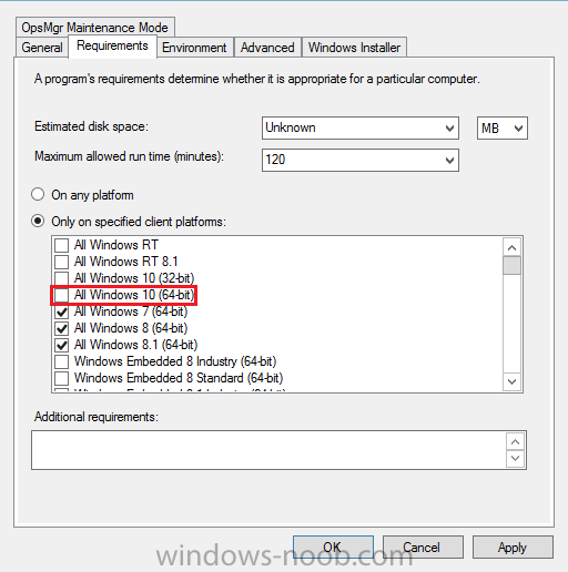

Hello,

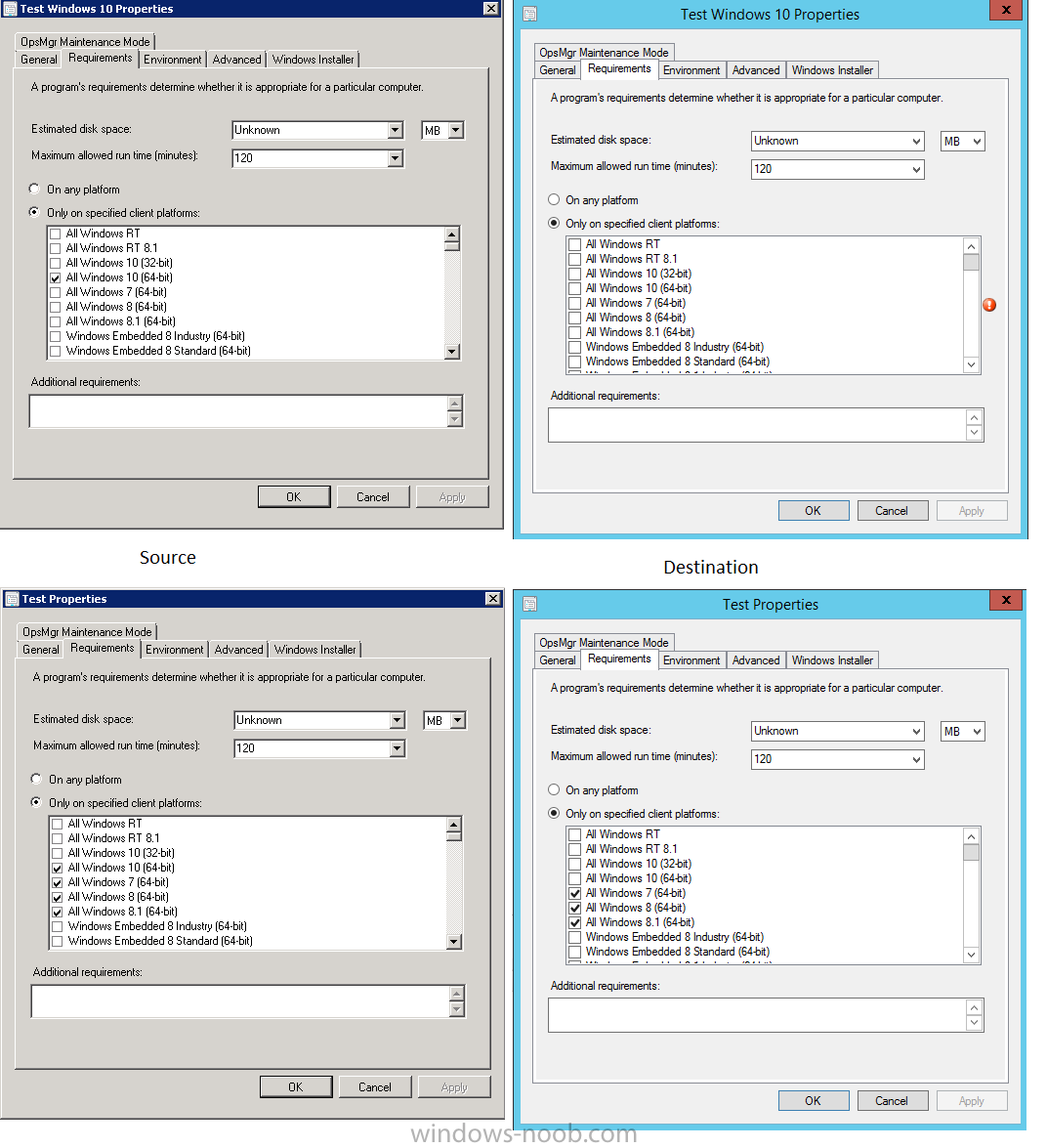

Just happened to notice that on all my 2012R2 packages, the "Requirements" tab on the Program seems to have not migrated the "All Windows 10 (64-bit)" setting. (I guess I can't say all but I'm through the 1st 10 packages and none of them have this checked as is on the source package.
Anyone else notice this or is this a known bug?

Also will mention that I noticed none of our Windows 10 packages appear to be running even though they are deployed. Further checking revealed a large majority of the packages were set to disabled rather than enabled.
I'm unable to duplicate the issue so not sure if its a bug or just something odd on our end. MS was unable to duplicate the issue as well but said there were a lot of bugs in regards to migration in the current version which will hopefully be fixed in the next CU.
