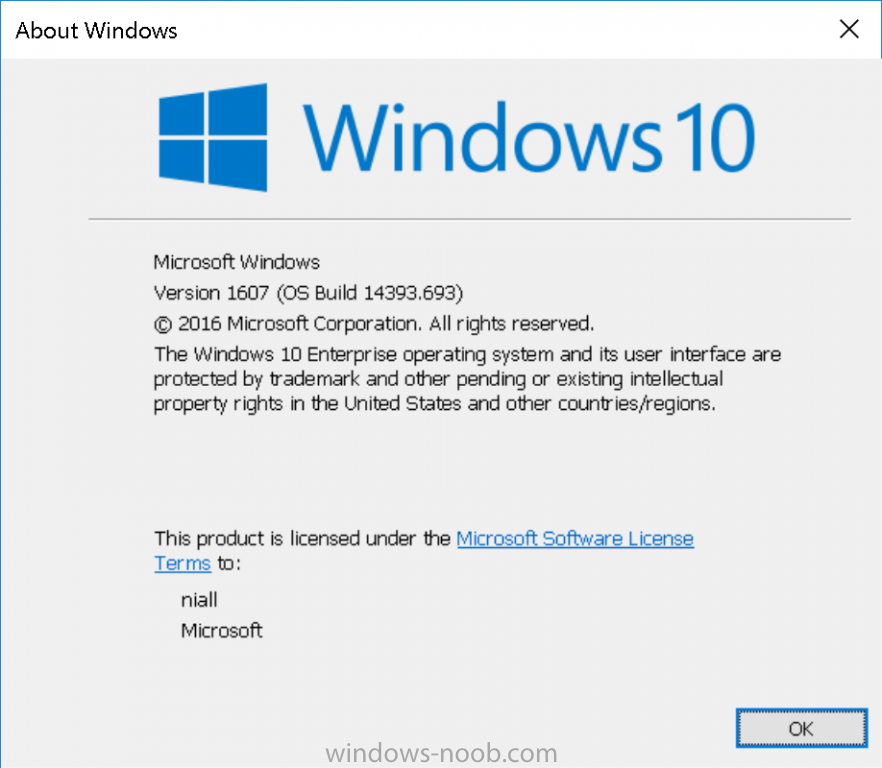

Microsoft have added the ability to use express updates in Windows 10 version 1607 (and LTSB Enterprise 2016) with the cumulative update released on patch Tuesday (January 2017 release) as detailed here. If your version of Windows 10 is later than Windows 10 version 1607 build 14393.693 you are good to go (on the client side) with express updates.
Express updates from Microsoft will be released from February 14th 2017 onward.
Note: If you have a previous version of Windows 10, then they will not be able to use express updates.

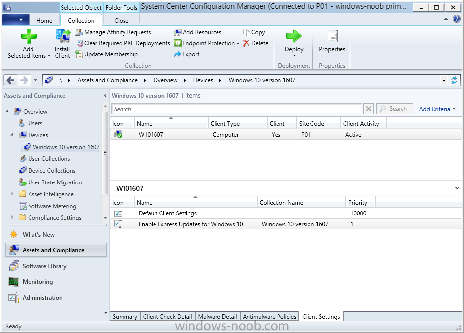

Once done, right click and choose deploy to deploy the custom client settings to a suitable collection containing Windows 10 version 1607 computers with the January 2017 cumulative update installed.
any computers in that collection will get the custom client settings as you see here
