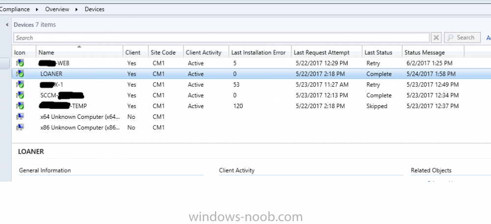

bmkiss67 Posted May 31, 2017 Report post Posted May 31, 2017 We have an isolated network with current branch(1606) installed and it does not work. It sees clients and it knows what updates the clients need, but nothing seems to get pushed to the clients. I’ve not had many issues using SCCM 2007 and 2012 in the same network so I don’t have a lot of trouble shooting experience. From my little experience I can’t figure out what’s wrong. Any suggestions on where to start looking? Any ideas would be highly appreciated. Thank you Quote Share this post Link to post Share on other sites More sharing options...

bmkiss67 Posted June 1, 2017 Report post Posted June 1, 2017 So let me give you our situation. We have an isolated network with a server (server A) running MS Server 2012 R2 and SCCM 2012 R2. We are replacing all of our machines, so with that we now have a server (server B) running MS Server 2012 R2 with SCCM current branch (v1606) installed in the same network. In an attempt to transition from SCCM on Server A to SCCM on Server B we altered a few things on server A. Discovery Methods Active Directory Forest Discovery has been turned off Active Directory Group has been turned off Active Directory System has been turned off Heartbeat Discovery is the only thing left on Because we do not want Server B to take everything over till we can get Server B to work correctly we have only set Discovery Methods Active Directory System is on Heartbeat Discovery is on By not having Active Directory Forest Discovery on the boundary was not made automatically. So we manually built the boundary with these settings Boundary Type – Active Directory Site Active Directory Site name: Default-First-Site-Name There is only one group Boundary Group and it has our 1 boundary in it. The component status was good for a few days and then I was getting errors on Site Status SUP and 2 (I don’t remember which 2) from Component Status. I had read something that made me look at the IIS Server (which is on Server B) and found that Application Pools -> WSUSpools was stopped. I don’t know why, but I restarted it and it has been fine for 4 days now. That also cleared up the Site/Component Status issues. SCCM (server B) would not install its own client; I had to manually do that. I current have 3 WIN 10 boxes; spilt into 2 collections and 2 Server 2012 R2 boxes in 2 collections. SCCM (server B) does see all the machines and sees what patches are needed for each client. I made a deployment for server B and for 1 of the Win 10 collections. And none of the machines have received any of the patches. When I look at the Software Update->A Compliance->Compliance 1 report it shows that the machines are not compliant. I’m not sure where to go from here. I hope I’ve included enough information this time. Any help would be greatly appreciated. Thank you Quote Share this post Link to post Share on other sites More sharing options...

bmkiss67 Posted June 7, 2017 Report post Posted June 7, 2017 So I see these errors in my wsyncmgr.log Can these errors be the cause of my issues? Failed to sync update 09dc7113-fa44-4ca8-9d70-ec254d4d2f04. Error: The Microsoft Software License Terms have not been completely downloaded and~~cannot be accepted. Source: Microsoft.UpdateServices.Internal.BaseApi.SoapExceptionProcessor.DeserializeAndThrow Sync failed: Failed to sync some of the updates. Source: Microsoft.SystemsManagementServer.SoftwareUpdatesManagement.WsusSyncAction.WSyncAction.SyncUpdates STATMSG: ID=6703 SEV=E LEV=M SOURCE="SMS Server" COMP="SMS_WSUS_SYNC_MANAGER" SYS=SCCM-B.project.local SITE=CM1 PID=2464 TID=5188 GMTDATE=Wed Jun 07 16:30:47.735 2017 ISTR0="Microsoft.SystemsManagementServer.SoftwareUpdatesManagement.WsusSyncAction.WSyncAction.SyncUpdates" ISTR1="Failed to sync some of the updates" ISTR2="" ISTR3="" ISTR4="" ISTR5="" ISTR6="" ISTR7="" ISTR8="" ISTR9="" NUMATTRS=0 Quote Share this post Link to post Share on other sites More sharing options...
