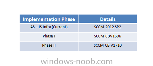

Phase I : Upgrade from SCCM 2012 SP2 to SCCM CB V1606
At Present, the Environment is having as below and mentioned with To - BE State
After Successful, Completion with Phase I - Progressing Phase II as follows (As-IS and To-BE Infra)
Please Validate if the As-IS to Phase I, II (To-BE) is Okay / Please suggest if any changes

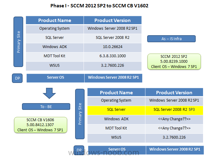

As - IS Infra:
SCCM 2012 SP2 with OSD, Application Deployment, Patch Management for Windows 7 SP1. With Single Standalone Primary Site and SQL On Same Server
SCCM 2012 SP2 is installed with Windows Server 2008 SP1 STD and SQL 2008 STD
Windows 10 ADK  - 10.0.26624
Distribution Points - 20 + Across All location With Windows Server 2008 SP1 Standard
Planned Infra:
We are looking further to upgrade the Operating System (Client OS) from Windows 7 to Windows 10 V1709
In order to that, We need to upgrade the SCCM Infrastructure.
Hence, As per the Plan Phase I:
Steps :
1. Retaining Windows Server 2008 On Primary Site and DP's
2. Performing SQL SP3 Update on SQL 2008 STD
3. Performing SCCM Upgrade from SCCM 2012 SP2 to SCCM CB V1606 using Baseline version
4.Installation of SCCM Client on all end Points
Now the Infrastructure will be upgraded from SCCM 2012 SP2 to SCCM CB V1606

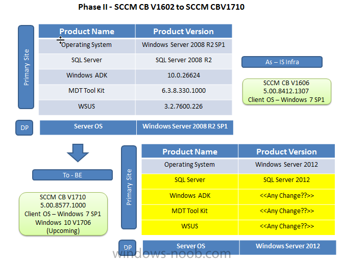

As per the Plan Phase II: (This is to Support both Windows 7 and Windows 10 V1709 Client Operating System)
SCCM CB V1606 to SCCM CB V1710
1. Upgrading the Primary Site Operating System from Windows Server 2008 SP1 to Windows Server 2012
2. Upgrading the SQL Server from SQL 2008 SP3 to SQL 2012 SP4
3. Uninstalling the OLD Windows 10 ADK and Install the new Windows 10 ADK (10.1.16299)
4. Uninstalling the WSUS/SUP Role and Reinstalling it again on Windows Server 2012
5. Running the CB Upgrade from SCCM CBV1606 to CBV1710
6. Installing SCCM Client CB V1710 on Windows 7 SP1 Computers
7. Preparation of Windows 10 Operating System in the Environment
Finally the Infrastructure with Windows 7 and Windows 10 OS, for Application Management, Patch Management, OS Deployment, Imaging., etc.,

As - IS Infra:
Steps :
