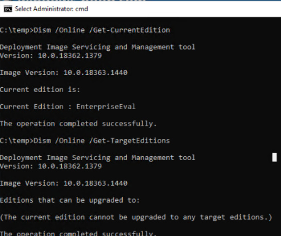

I am facing weird issue. I am evaluating Windows and Office Deployment Lab Kit which has everything configured. I created few VMs using Windows 10 v1909 Enterprise ISO downloaded from https://www.microsoft.com/en-in/evalcenter .
I am testing Feature Update from v1909 to 20H1 and 20H2. But somehow none of the v1909 machines shows FU as required. I have installed all the updates including latest SSU and CU from Microsoft Updates online.
When I tried to use In-Place Upgrade TS that also failed at compatibility scan due to edition not supported error, to be specific: Windows setup completed with exit code hexadecimal 0xC1900204 (decimal 3247440388)
I ran below commands on the wim which I used to build VM which is base wim extracted from ISO. /Get-Targeteditions shows: The current edition cannot be upgraded to any target editions.
Does that mean TechNet Eval ISOs cannot used for testing Feature Update (FU)/IPU testing or am I missing something obvious?
Same is true for v1809 to 20H1/20H2.  I have also attached logs from FU and IPU TS for reference.
setupact.log setuperr.log smsts.log
I think you've answered your own question, the Enterprise Eval editions cannot be upgraded as they are evaluation editions
try with a licensed iso and you'll see the results you desire
