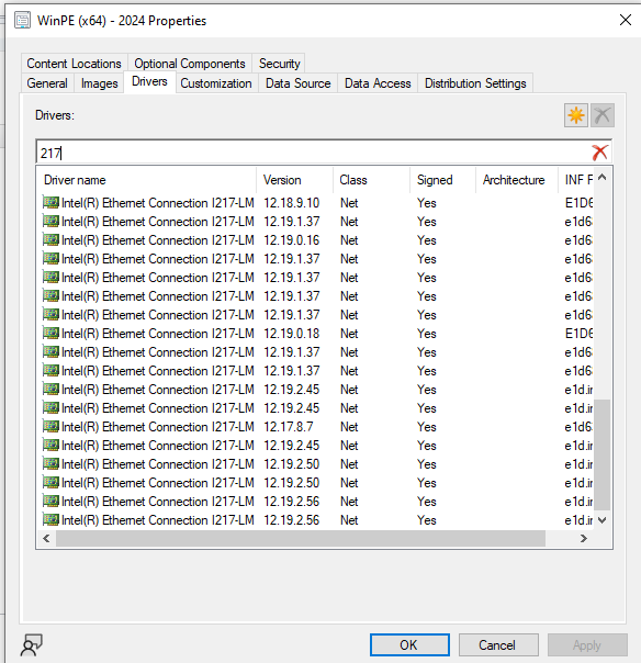

Is this common to have duplicate drivers in the boot image as seen in the picture.  Is it okay to have mulitple versions or should i just have the latest version as well there are multiple drivers with the same version.  Not sure if this can cause issues or not.
Thanks

it will use LIFO method (LAST IN FIRST OUT), meaning, the last task sequence deployed to whatever collection your computer is in, that is the boot image it will pull down, if you select a different task sequence deployed to the same computer or collection, and that task sequence has a different boot image attached to it, then it will stage that new boot image once you select the task sequence
