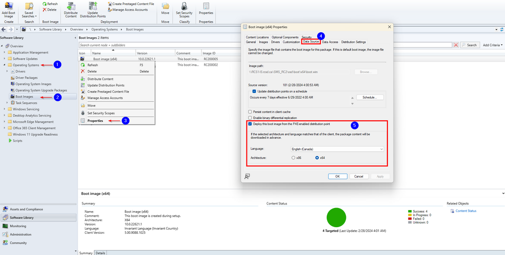

In Software Library expand Operating Systems, click on Boot Images, right click the x64 version and select Properties. Go into the Data Source tab and check off the box "Deploy this boot image from the PXE-enabled distribution point".
Thanks a lot. Just curious, mine is grayed out for the architecture and I didn't select any language, does it make any difference, compared to yours?
