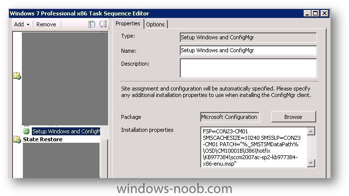

you need the clients patched as well, if they are not, then the client version will be reported at the SP2 level...
see below:-

to automatically add the hotfix required you can use this method http://blogs.technet.com/b/deploymentguys/archive/2010/08/13/automatically-populate-the-patch-property-for-the-configmgr-2007-client-installation.aspx
or use the Patch property as described here, here and here
sample patch property in a ts below:-
Thanks for the reply, very helpful. I have created the task sequence and added correct configuration but I'm struggling with the Installation properties parameters.
Can Anyone help me? This is more than likely the last step in the process, hoping I can get it resolved soon.

Anyweb...thanks for the reply.
1. Created task sequence with the following parameters : PATCH="%_SMSTSMDataPath%\OSD\<PCS00009>\i386\hotfix\KB977384\SCCM2007AC-SP2-KB977384-x86.msp
2. Advertised Task Sequence
3. Checked Advertisement status in SCCM Console which reports Received 83, Started 86, Program Success 86.
4 Checked logs for valid install Hostname i.e R1-1 which shows as : "The task sequence execution engine successfully completed a task sequence." & also "The task sequence manager successfully completed execution of the task sequence." under logs.
5. Remote Desktop onto R1-1 and checked Configuration Manager Version number which shows as .2000
6. Checked SCCM Console R1-1 Properties and verified version of .2000 there also.
Client Push installation properties reads: SMSSITECODE=PCS SMSCACHESIZE=8000
