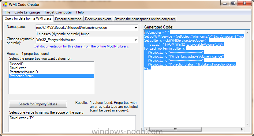

Using Wmi Code Creator I put together a simple code to check for the value of this class, so the first code looked like this
strComputer = "."
Set objWMIService = GetObject("winmgmts:\\" & strComputer & "\root\CIMV2\Security\MicrosoftVolumeEncryption")
Set colItems = objWMIService.ExecQuery( _
"SELECT * FROM Win32_EncryptableVolume",,48)
For Each objItem in colItems
Wscript.Echo "-----------------------------------"
Wscript.Echo "Win32_EncryptableVolume instance"
Wscript.Echo "ProtectionStatus: " & objItem.ProtectionStatus
Next
