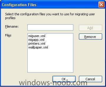

It's looking for the "MigSys.xml" config file that is not copied to the DP.

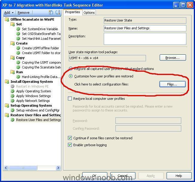

Check your scanstate command-line syntax in the "Capture User State" step of the TS - if the "MigSys.xml" file isn't referenced in the command line, then check the SCCM GUI reference to the scanstate/loadstate config files (see below). Make sure that in "Capture User Files and Settings" and in "Restore User Files and Settings" that your config files match in each step. I had a similar issue where I mis-typed "MigApp.xml" as "MigCpp.xml," and it was bombing the loadstate each time.
Bronx Bull is correct..
In your task sequence steps for capture and restore you should have either:
MigApp.xml & MigUser.xml OR MigApp.xml & MigDocs.xml (You cant use User & Docs together).
Additional xml files, such as printers or wallpaper can also be added. You can't add a Config.xml file in my experience though, as it needs a seperate command /config:<filename.xml> rather than /i:<filename.xml> so if you want to use a Config.xml as well it needs to be added to the task sequence variable
OSDMigrateAdditionalCaptureOptions in a seperate step.
