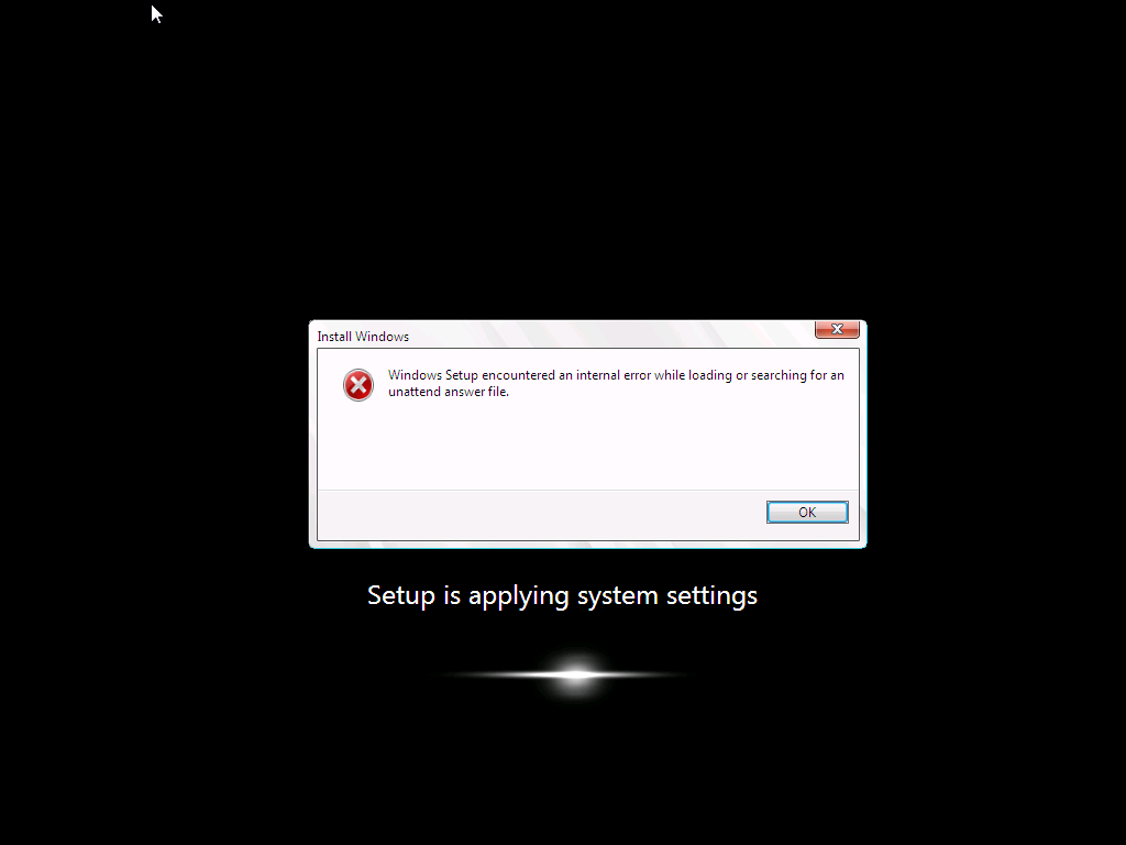

So what error did the customer see ? When they applied the language pack offline step, the Setup Windows and Configmgr step would restart the computer into Windows Setup and at this point shortly after, the installation would fail with the following error message
Windows setup encountered an internal error while loading or searching for an unattend answer file

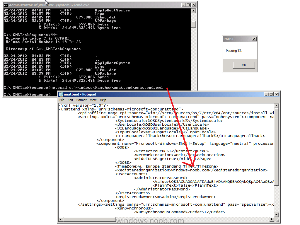

As part of this troubleshooting I used a technique called pausing the task sequence to review logs/files before and after steps were taking place. I'd highly recommend you try pausing your task sequence if you are having issues debugging it. I would pause the task sequence and verify that the unattend.xml file was in the right place, it was present in c:\windows\panther\unattend\unattend.xml and it looked correct.

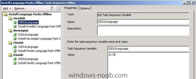

The next test I did was to rule out the Install Language Pack step itself, so I disabled that step (the group actually) and the installation of Windows 7 continued without any problems at all. Great, it must be the language pack ! The image the customer was deploying was Windows 7 Enterprise X86 Service Pack 1, so I made sure they downloaded the language pack files for that version of Windows, yes there are language pack files for both X86 and X64 so I wanted to be sure they were using the right ones, In addition, I recreated the language package used in the deployment task sequence, redistributed it to the distribution points and added that new package into the task sequence. I started another installation and noticed that the Apply Language Pack offline step was running through very quickly, normally when installing a language pack it takes some time to complete, this is an indication that something is wrong. Once again, dism pointed to the exact same failure as noted above, ok, i've ruled out the customers Unattend.xml file, I've ruled out the Language pack what else could it be.
The steps in the task sequence
Finally I looked very closely at each step in the task sequence involved in the Language pack installation, I examined each of the Set Task Sequence variable steps and made sure they were correct and that they were in the correct sequence and indeed that these steps were occuring after Apply windows settings, apply network settings but before Setup Windows and configMgr, they were all fine... and in the right place.

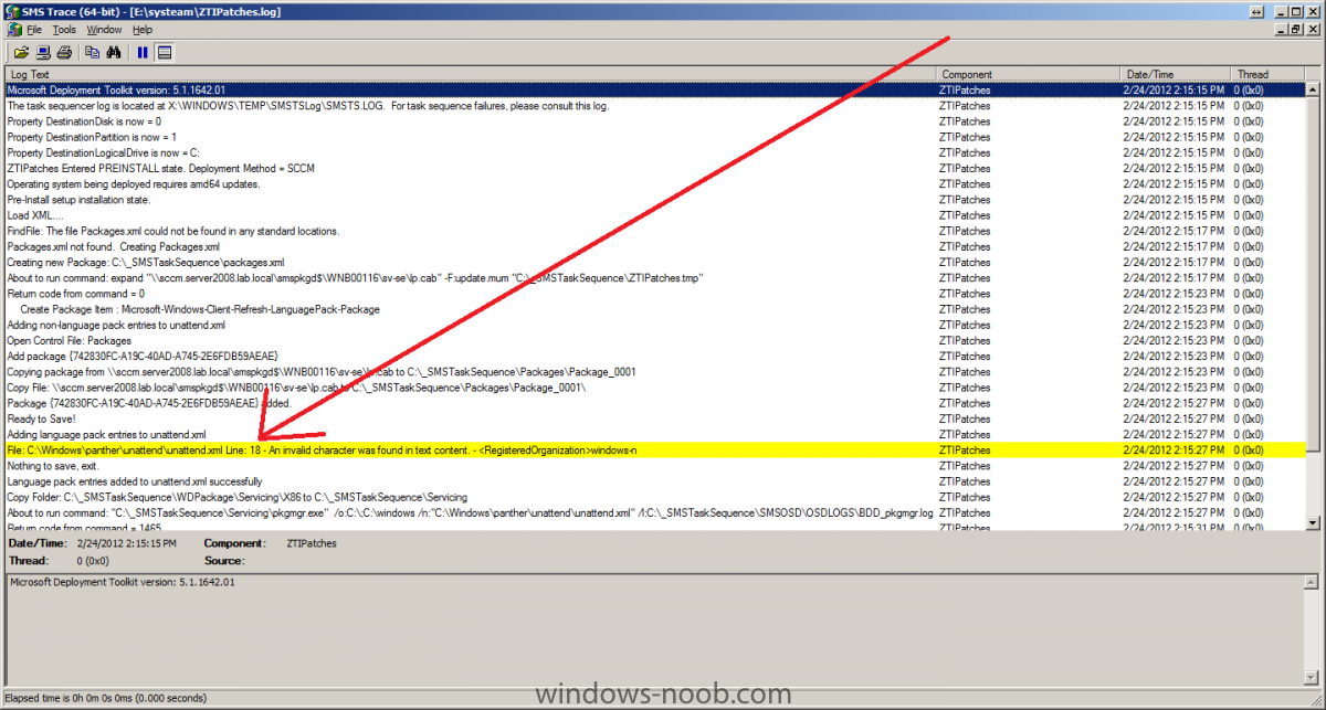

so then I opened the ZTIPatches.log file (this file is used to log information when installing updates or language packs offline) and it was there I had the Eureka moment
line 18 an invalid character was found in text content. <RegisteredOrganization>
line 18 an invalid character was found in text content. RegisteredOrganization.png

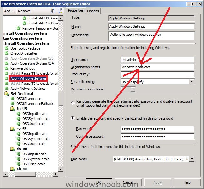

huh ? could this be true, ok I opened the Unattend.XML file that the customer had and Registered Organization was not present, so I started another installation and opened the c:\windows\panther\unattend\unattend.xml file that was present, still no Registered Organization, so i let the installation continue right up until after the Apply Windows Settings Step and at this point the unattend.xml file DID have the Registered Organization field present, infact, it's added in the Apply Windows Settings step.
And what I saw was the Eureka moment, the Registered Organization had a Swedish character present in it's name, i'm not going to name that company but I will show you what it could look like here
so that was it !, I changed the Registered Organization name, by removing the Swedish characters and replacing them with standard 'o's and the problem was resolved and DISM worked correctly and the language packs got installed. Basically what this meant was that DISM wanted to interpret the unattend.xml file in order to know what it had to inject into the offline image, it couldn't understand the unattend.xml file due to the Swedish characters being present and therefore bombed out of what it was doing with a parse error message. Replacing the Registered Organization name with one that contained only English characters allowed DISM to work correctly and all was good. The log files really don't lie !
