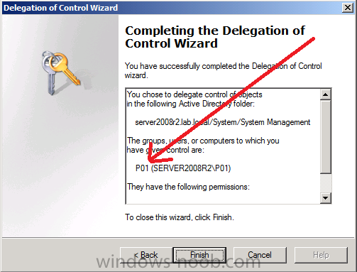

christianhau 0 Posted May 10, 2012 Report post Posted May 10, 2012 Hi! Excellent tutorial! I tried installing it by myself before I found this guide and had problems with the prerequisite check regarding collation and user rights. I tried following your guide with the exception that I used my existing DC in a lab I have, I created two brand new machines for the installation of SCCM. All is well untill I get to the following prerequisite check:http://dl.dropbox.com/u/5041604/P01.png The sccm log has the following information: INFO: File hash check successfully for DeviceClient_WinCE7.0_X86.CAB $$<Configuration Manager Setup><05-09-2012 12:38:24.401-120><thread=2652 (0xA5C)> INFO: setupdl.exe: Finish $$<Configuration Manager Setup><05-09-2012 12:38:24.401-120><thread=2924 (0xB6C)> INFO: Attempting to load resource DLL... $$<Configuration Manager Setup><05-09-2012 12:38:58.670-120><thread=2136 (0x858)> INFO: Registered type P01.CHRISTIANHAUGEN.COM MSSQLSERVER\MASTER for P01.christianhaugen.com MSSQLSERVER\master $$<Configuration Manager Setup><05-09-2012 12:38:58.670-120><thread=2136 (0x858)> INFO: Registered type SMS Master for P01.christianhaugen.com MSSQLSERVER\master $$<Configuration Manager Setup><05-09-2012 12:38:58.670-120><thread=2136 (0x858)> INFO: Registered type P01.CHRISTIANHAUGEN.COM MSSQLSERVER\CM_CHK for P01.christianhaugen.com MSSQLSERVER\CM_CHK $$<Configuration Manager Setup><05-09-2012 12:38:58.670-120><thread=2136 (0x858)> INFO: Registered type SMS ACCESS for P01.christianhaugen.com MSSQLSERVER\CM_CHK $$<Configuration Manager Setup><05-09-2012 12:38:58.670-120><thread=2136 (0x858)> INFO: Attempting to load resource DLL... $$<Configuration Manager Setup><05-09-2012 12:38:58.670-120><thread=2136 (0x858)> INFO: Prerequisite rules for primary site fresh installation are being run. $$<Configuration Manager Setup><05-09-2012 12:38:58.670-120><thread=1504 (0x5E0)> INFO: File \\P01.christianhaugen.com\admin$\sms_lanman_test_svc.exe does not exist. No zapping needed. $$<Configuration Manager Setup><05-09-2012 12:38:58.670-120><thread=1504 (0x5E0)> INFO: Verifying Configuration Manager Active Directory Schema Extensions. $$<Configuration Manager Setup><05-09-2012 12:39:07.597-120><thread=1504 (0x5E0)> INFO: Found DS Root:CN=Schema,CN=Configuration,DC=christianhaugen,DC=com~ $$<Configuration Manager Setup><05-09-2012 12:39:07.628-120><thread=1504 (0x5E0)> INFO: Verifying Configuration Manager Active Directory Domain Function Level. $$<Configuration Manager Setup><05-09-2012 12:39:07.628-120><thread=1504 (0x5E0)> INFO: Found Domain Function level: 4~ $$<Configuration Manager Setup><05-09-2012 12:39:07.644-120><thread=1504 (0x5E0)> The installed WSUS build (0.0.0.0) does not have the valid and supported WSUS Administration DLL assembly version. Please install WSUS 3.0 SP2 (minimum 3.1.6001.65) or above~ $$<Configuration Manager Setup><05-09-2012 12:39:07.800-120><thread=1504 (0x5E0)> CWmi::GetFirstObjectFromQuery() : IEnumWbemClassObject->Next() returned zero objects. - 0x80004005~ $$<Configuration Manager Setup><05-09-2012 12:39:08.222-120><thread=1504 (0x5E0)> INFO: File \\P01.christianhaugen.com\admin$\sms_get_ADPERMS_svc.exe does not exist. No zapping needed. $$<Configuration Manager Setup><05-09-2012 12:39:08.238-120><thread=1504 (0x5E0)> CSql Error: Cannot find type data, cannot get a connection. $$<Configuration Manager Setup><05-09-2012 12:39:15.945-120><thread=1504 (0x5E0)> *** [08001][14][Microsoft][ODBC SQL Server Driver][DBMSLPCN]Invalid connection. $$<Configuration Manager Setup><05-09-2012 12:40:16.840-120><thread=1504 (0x5E0)> *** [01000][14][Microsoft][ODBC SQL Server Driver][DBMSLPCN]ConnectionOpen (ParseConnectParams()). $$<Configuration Manager Setup><05-09-2012 12:40:16.840-120><thread=1504 (0x5E0)> *** Failed to connect to the SQL Server. $$<Configuration Manager Setup><05-09-2012 12:40:16.840-120><thread=1504 (0x5E0)> *** [08001][14][Microsoft][ODBC SQL Server Driver][DBMSLPCN]Invalid connection. $$<Configuration Manager Setup><05-09-2012 12:41:18.417-120><thread=1504 (0x5E0)> *** [01000][14][Microsoft][ODBC SQL Server Driver][DBMSLPCN]ConnectionOpen (ParseConnectParams()). $$<Configuration Manager Setup><05-09-2012 12:41:18.417-120><thread=1504 (0x5E0)> *** Failed to connect to the SQL Server. $$<Configuration Manager Setup><05-09-2012 12:41:18.417-120><thread=1504 (0x5E0)> ERROR: The current user does not have administrative rights on computer: P01.christianhaugen.com. $$<Configuration Manager Setup><05-09-2012 12:41:18.417-120><thread=1504 (0x5E0)> ERROR: Prerequisite checking stopped on this machine. $$<Configuration Manager Setup><05-09-2012 12:41:18.417-120><thread=1504 (0x5E0)> INFO: File \\P01.christianhaugen.com\admin$\sms_client_test_svc.exe does not exist. No zapping needed. $$<Configuration Manager Setup><05-09-2012 12:41:19.167-120><thread=1504 (0x5E0)> INFO: P01.christianhaugen.com is a 64 bit operating system. $$<Configuration Manager Setup><05-09-2012 12:41:26.952-120><thread=1504 (0x5E0)> I installed the sql database with the correct collation, and I have tried to change the collation of the individual database as well as I create it. I used the smsadmin user that your mentioned, but also set the sql running accounts as the domain administrator just to see if that worked and I still got the same error. Have you got any idea what might be causing this? Thanks in advance!! Quote Share this post Link to post Share on other sites

anyweb 478 Posted May 11, 2012 Report post Posted May 11, 2012 Hi! Excellent tutorial! I tried installing it by myself before I found this guide and had problems with the prerequisite check regarding collation and user rights. I tried following your guide with the exception that I used my existing DC in a lab I have, I created two brand new machines for the installation of SCCM. All is well untill I get to the following prerequisite check:http://dl.dropbox.com/u/5041604/P01.png The sccm log has the following information: INFO: File hash check successfully for DeviceClient_WinCE7.0_X86.CAB $$<Configuration Manager Setup><05-09-2012 12:38:24.401-120><thread=2652 (0xA5C)> INFO: setupdl.exe: Finish $$<Configuration Manager Setup><05-09-2012 12:38:24.401-120><thread=2924 (0xB6C)> INFO: Attempting to load resource DLL... $$<Configuration Manager Setup><05-09-2012 12:38:58.670-120><thread=2136 (0x858)> INFO: Registered type P01.CHRISTIANHAUGEN.COM MSSQLSERVER\MASTER for P01.christianhaugen.com MSSQLSERVER\master $$<Configuration Manager Setup><05-09-2012 12:38:58.670-120><thread=2136 (0x858)> INFO: Registered type SMS Master for P01.christianhaugen.com MSSQLSERVER\master $$<Configuration Manager Setup><05-09-2012 12:38:58.670-120><thread=2136 (0x858)> INFO: Registered type P01.CHRISTIANHAUGEN.COM MSSQLSERVER\CM_CHK for P01.christianhaugen.com MSSQLSERVER\CM_CHK $$<Configuration Manager Setup><05-09-2012 12:38:58.670-120><thread=2136 (0x858)> INFO: Registered type SMS ACCESS for P01.christianhaugen.com MSSQLSERVER\CM_CHK $$<Configuration Manager Setup><05-09-2012 12:38:58.670-120><thread=2136 (0x858)> INFO: Attempting to load resource DLL... $$<Configuration Manager Setup><05-09-2012 12:38:58.670-120><thread=2136 (0x858)> INFO: Prerequisite rules for primary site fresh installation are being run. $$<Configuration Manager Setup><05-09-2012 12:38:58.670-120><thread=1504 (0x5E0)> INFO: File \\P01.christianhaugen.com\admin$\sms_lanman_test_svc.exe does not exist. No zapping needed. $$<Configuration Manager Setup><05-09-2012 12:38:58.670-120><thread=1504 (0x5E0)> INFO: Verifying Configuration Manager Active Directory Schema Extensions. $$<Configuration Manager Setup><05-09-2012 12:39:07.597-120><thread=1504 (0x5E0)> INFO: Found DS Root:CN=Schema,CN=Configuration,DC=christianhaugen,DC=com~ $$<Configuration Manager Setup><05-09-2012 12:39:07.628-120><thread=1504 (0x5E0)> INFO: Verifying Configuration Manager Active Directory Domain Function Level. $$<Configuration Manager Setup><05-09-2012 12:39:07.628-120><thread=1504 (0x5E0)> INFO: Found Domain Function level: 4~ $$<Configuration Manager Setup><05-09-2012 12:39:07.644-120><thread=1504 (0x5E0)> The installed WSUS build (0.0.0.0) does not have the valid and supported WSUS Administration DLL assembly version. Please install WSUS 3.0 SP2 (minimum 3.1.6001.65) or above~ $$<Configuration Manager Setup><05-09-2012 12:39:07.800-120><thread=1504 (0x5E0)> CWmi::GetFirstObjectFromQuery() : IEnumWbemClassObject->Next() returned zero objects. - 0x80004005~ $$<Configuration Manager Setup><05-09-2012 12:39:08.222-120><thread=1504 (0x5E0)> INFO: File \\P01.christianhaugen.com\admin$\sms_get_ADPERMS_svc.exe does not exist. No zapping needed. $$<Configuration Manager Setup><05-09-2012 12:39:08.238-120><thread=1504 (0x5E0)> CSql Error: Cannot find type data, cannot get a connection. $$<Configuration Manager Setup><05-09-2012 12:39:15.945-120><thread=1504 (0x5E0)> *** [08001][14][Microsoft][ODBC SQL Server Driver][DBMSLPCN]Invalid connection. $$<Configuration Manager Setup><05-09-2012 12:40:16.840-120><thread=1504 (0x5E0)> *** [01000][14][Microsoft][ODBC SQL Server Driver][DBMSLPCN]ConnectionOpen (ParseConnectParams()). $$<Configuration Manager Setup><05-09-2012 12:40:16.840-120><thread=1504 (0x5E0)> *** Failed to connect to the SQL Server. $$<Configuration Manager Setup><05-09-2012 12:40:16.840-120><thread=1504 (0x5E0)> *** [08001][14][Microsoft][ODBC SQL Server Driver][DBMSLPCN]Invalid connection. $$<Configuration Manager Setup><05-09-2012 12:41:18.417-120><thread=1504 (0x5E0)> *** [01000][14][Microsoft][ODBC SQL Server Driver][DBMSLPCN]ConnectionOpen (ParseConnectParams()). $$<Configuration Manager Setup><05-09-2012 12:41:18.417-120><thread=1504 (0x5E0)> *** Failed to connect to the SQL Server. $$<Configuration Manager Setup><05-09-2012 12:41:18.417-120><thread=1504 (0x5E0)> ERROR: The current user does not have administrative rights on computer: P01.christianhaugen.com. $$<Configuration Manager Setup><05-09-2012 12:41:18.417-120><thread=1504 (0x5E0)> ERROR: Prerequisite checking stopped on this machine. $$<Configuration Manager Setup><05-09-2012 12:41:18.417-120><thread=1504 (0x5E0)> INFO: File \\P01.christianhaugen.com\admin$\sms_client_test_svc.exe does not exist. No zapping needed. $$<Configuration Manager Setup><05-09-2012 12:41:19.167-120><thread=1504 (0x5E0)> INFO: P01.christianhaugen.com is a 64 bit operating system. $$<Configuration Manager Setup><05-09-2012 12:41:26.952-120><thread=1504 (0x5E0)> I installed the sql database with the correct collation, and I have tried to change the collation of the individual database as well as I create it. I used the smsadmin user that your mentioned, but also set the sql running accounts as the domain administrator just to see if that worked and I still got the same error. Have you got any idea what might be causing this? Thanks in advance!! what exact version of SQL server did you install ? when running the SPLASH.HTA are you logged in as a domain user or as local administrator ? Quote Share this post Link to post Share on other sites

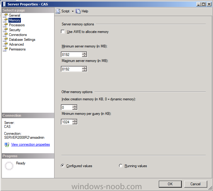

Iroqouiz 28 Posted June 15, 2012 Report post Posted June 15, 2012 The SQL memory requirements seem a bit excessive to me. We have a very small environment, maybe 300 machines, tops. Would 3 GB memory be enough to allocate for SQL? Quote Share this post Link to post Share on other sites
hypercube33 0 Posted June 29, 2012 Report post Posted June 29, 2012 The memory requirements seem to help it in performance. SCCM collects quite a bit of data and is being very well utilized by the system. We have about 250~ clients and we are considering using more to boost speed. Quote Share this post Link to post Share on other sites

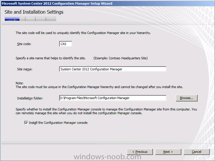

Acid_Stop 0 Posted July 1, 2012 Report post Posted July 1, 2012 Hi Anyweb! Great guides and awesome that you include screenshots. Is there any reason why you install programs to the D drive vs C? Is this a best practice? Quote Share this post Link to post Share on other sites
anyweb 478 Posted July 1, 2012 Report post Posted July 1, 2012 best practise would entail separating the different programs (OS, Configuration Manager, SQL Server 2008) to different physical disks and to use RAID 10, for example OS on C:\, Configmgr on D:\ SQL on E:\ and so on.. but as this is only a lab i've just installed Configuration Manager and SQL Server 2008 R2 on D:\. The reason you'd keep them on different physical discs is all about IOPS (input output per second). If you want more info on that see here and refer to the advice from Technet here, from which I've pasted some info below.. Configuration Manager Site Systems This section identifies recommended hardware configurations for Configuration Manager site systems. In general, the key factors that limit performance of the overall system include the following, in order: Disk I/O performance Available memory CPU For best performance, use RAID 10 configurations for all data drives and 1Gbps Ethernet network connectivity between site system servers, including the database server. Quote Share this post Link to post Share on other sites
