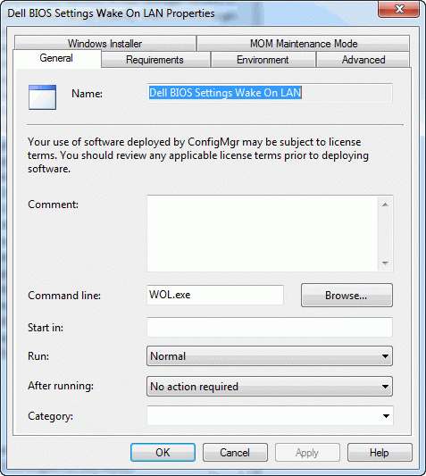

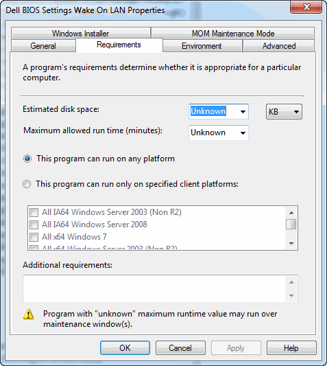

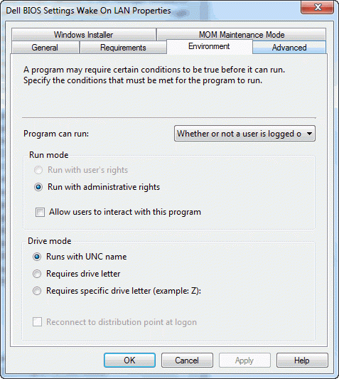

Trying to enable Wake on LAN to a mass amount of already deployed workstations. I pulled down Dell's CCTK. Enabled the Wake on LAN feature for all models and dumped out an EXE from the software. Packaged it in SCCM, and it successfully gets pulled down. However, when SCCM is running the install execmgr.log keeps telling me:
Script for Package:CU100103, Program: Dell BIOS Settings Wake On LAN failed with exit code 10
The advertisement status on the console tells me the same information.

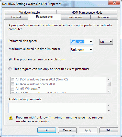

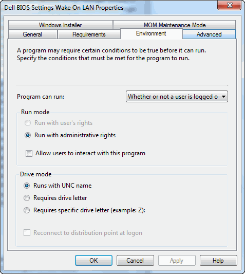

Has anyone had much experience deploying CCTKs this way? I have included images of the packages program settings; as it might be something in the manor I am telling it to run.

Are you installing the HAPI driver before running the cctk exe? I had the same issue, and just created a quick batch file to install the HAPI driver first. I found it much easier just to do the command line option, rather than using the exe that the gui software created. All command line options are given here:

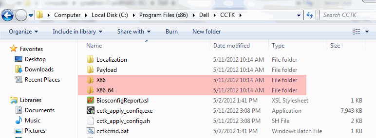

Copy the x86 and x86_64 folders from the local install directory (i.e. C:\Program Files (x86)\Dell\CCTK).
  1.
Paste these folders to your SCCM servers source files directory.

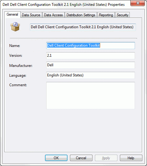

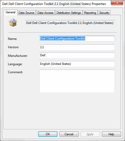

From the SCCM console navigate to Computer Management > Software Distribution > Packages.
  1.
Create a new package using the source files mentioned above.
  1.

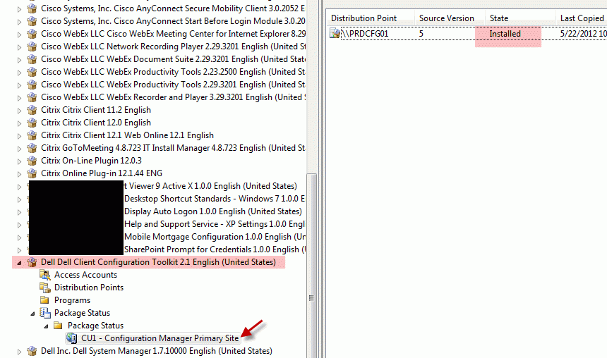

Add this package to the DP and Update the DP. Ensure the package was successfully installed to the DP.post-14550-0-83645800-1339002836_thumb.gif

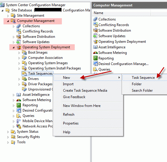

From the SCCM console navigate to Computer Management > Operating System Deployment > Task Sequences.
Create a new Task Sequence.

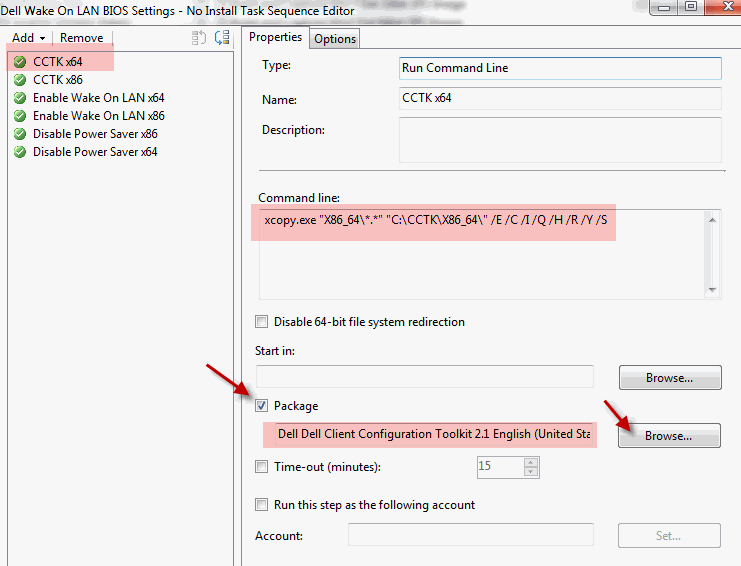

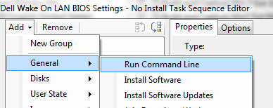

In the newly created TS click Add > General > Run Command Line
  1.

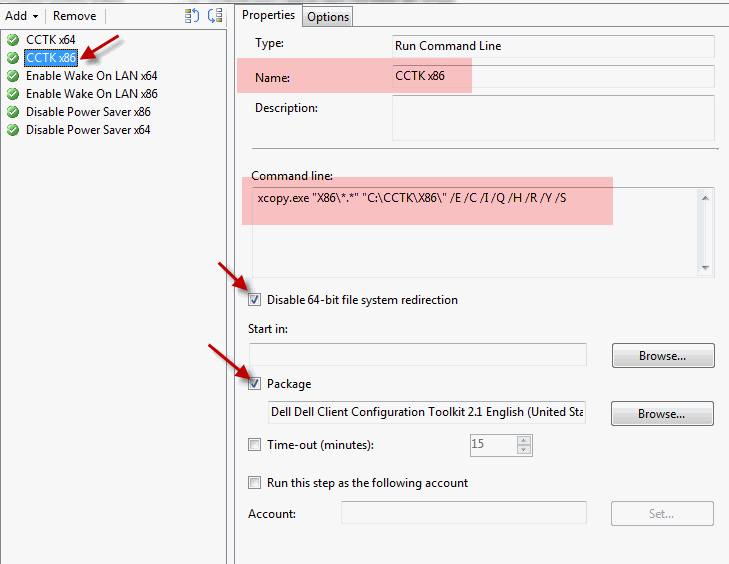

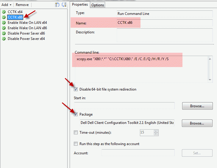

Use this XCOPY command for copying the x86_64 to the targeted client’s C drive.
xcopy.exe "X86_64\*.*" "C:\CCTK\X86_64\" /E /C /I /Q /H /R /Y /S
Check the Package check box and browse the package we created in step 6.
  1.
Navigate to the Options tab click Add Condition > Operating System Version. And define the variable to only run on a x64 bit OS.
  1.

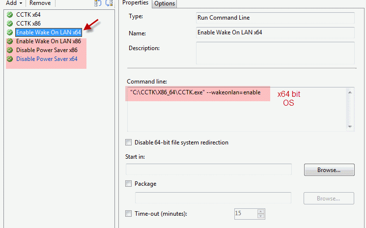

Repeat steps 11 to 13 ensuring you are using the x86 bit version of CCTK (run command xcopy.exe "X86\*.*" "C:\CCTK\X86\" /E /C /I /Q /H /R /Y /S). And add a condition so it only runs on an x86 bit OS. Check the disable 64-bit file system redirection check box.
  1.
Refer to Dell’s CCTK user manualfor a listing CCTK commands to change the systems BIOS settings. Create separate run commands for the desired changes ensure the proper x64 and x86 CCTK.exe is running on the respective clients (i.e. Step 13).
