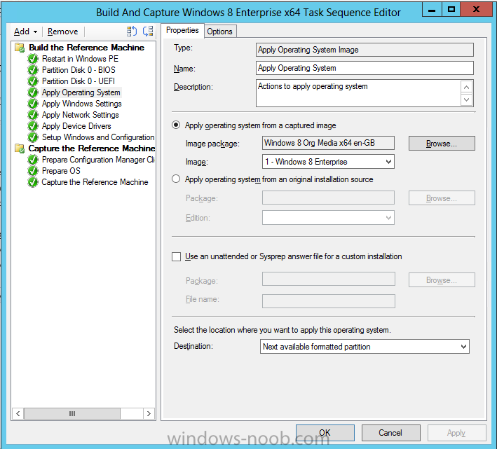

How does your "apply Operating system" look like what img are you applying?
That's one new thing i have noticed aswell, if i create a new Build And Capture TS, i can't choose my "Original installation source" (OS Installers) i seem to only be able to pick captured .wim files, and the only captured .wim files i have is Windows 7, and i don't wana use that :P
So i Copy my old TS and there i have this option (in the pciture) to add my Win8 original installation source (the package i have on my DP)
Yes in SP1 just add the Install.wim from the installation source and then do a build and capture from that wim.
This is how my TS looks like in SP1 if you chose the Win8 install.wim
EDIT, Create a NEW TS and point it to the new image, dont copy the windows 7 one.

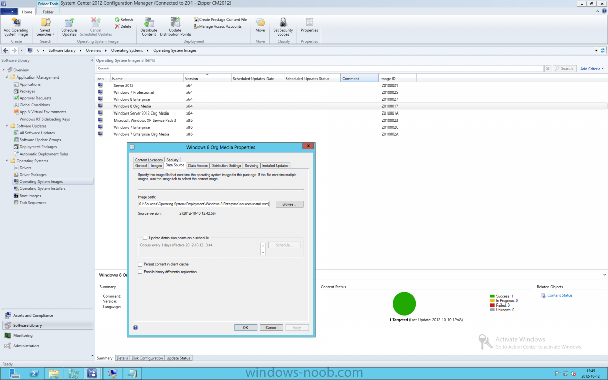

You have to add the WIM file from the Windows 8 source to your "Operating system installers" like here.
Ahh i took the entire folder and created a OS installer :
Instead i should just use the install.wim in \\sources\ ? :
Yes sir!
Use the Install.Wim and make a new Operating System Image , then you create a build and capture TS from that . Should work! :)

This is what my TS looks like:
