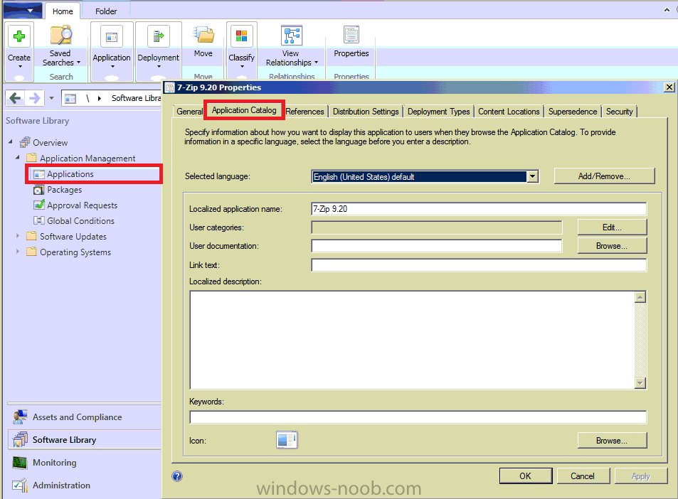

Nope, only Applications can end up in the Application Catalog, it's one of the features of the New Application Model (packages are the OLD model)
however you can certainly add an application with a custom deployment type (and therefore use that application to load an EXE or VBS or whatever) and that application can display in the Application Catalog..
