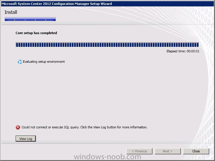

error during installation
During installation I receive an error:
ConfigMgrSettupWizard.log shows:

7-11-2012 11:30:41: ConfigMgrSetupWizard Verbose: 1 : Received error [Could not connect or execute SQL query.] from native code.
7-11-2012 11:30:41: ConfigMgrSetupWizard Verbose: 1 : Completed the site installation thread.

~===================== Failed Configuration Manager 2012 Server Setup ===================== Configuration Manager Setup 7-11-2012 11:30:41 1904 (0x0770)
(domain name and netbios names changed)
Installation account has the sysadmin role on the sql server and the computeraccount also.
Sql server is a remote computer SQL server 2008 R2 with sp2
Can anyone help me?
Yes it is, the installation domain account is a member of the local admin group on the appl server and also on the remote sql server. Even the computeraccount is a member off the local admin group and added in the sql management studio to the sccm instance and has the sysadmin role.
problem fixed; settings in tcp/ip properties of the sql instance service. ip1, ip2, ip3 and ipall all set to enabled and filled in the tcp port.
another question: installation account and computeraccount are member of the local admin group. When the installation is finished, are these rights still necessary?
