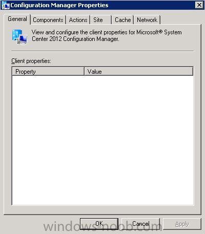

We upgraded from SCCM 2007 to SCCM 2012 in March of 2013. The update went rather well and all computers that had the old 2007 client successfully upgraded to 2012. Our current configuration is one Primary Server with no Secondary Servers. Within the last month or so, two of our servers became INACTIVE in the SCCM console - both of these servers are Windows 2003 Server, one is 32 bit and the other is 64 bit. The 32 bit Windows 2003 Server is going to be retired soon, so that's the server I did my troubleshooting on. What I found on that server was in the Configuration Manager in the Control Panel, all tabs show blank white windows, even thought it used to have the same information in it as the other servers that aren't having the issue.
The General, Components, Actions, Site, Cache, and Network tabs have absolutely no information and are blank. When I click on the Site tab and click on Find Site, it successfully finds my Primary Site Server and I get a message that Configuration Manager has successfully found a site to manage this client, but when I click Apply, I get an error message that Failed to update site assignment and the site code stays empty.

Thanks for the reply Garth. Yes, I checked that as well - and the Default Namespace is root\cimv2. That's why I have been pulling my hair out... I obviously MUST be missing something, yet I feel that I tried everything.
When I go into the Configuration Manager in the Control Panel, like I said before, all tabs are blank. If I go to the site tab and click on Find Site, it successfully finds the site code without me having to enter it, but when I click APPLY, I get an error that ConfigMgr cannot update the site. See below:
post-21103-0-88679300-1376067226_thumb.jpg post-21103-0-87219400-1376067245_thumb.jpg

This last weekend, I came in off hours to do Windows Updates on this server manually. After I installed Windows Updates and rebooted I got some WMI errors on different software. Although risky, I rebuilt WMI just like I did on the "close to retirement server" mentioned above. This fixed the issues I was having with the software I had issues with after the reboot but my Configuration Manager was still blank at that time. I got an error message during the WMI rebuild but I really wasn't thinking about the Config Manager.
When I came in this morning, I thought I'd check it just to see if anything changed. Low and behold, the Configuration Manager is no longer blank and is showing ACTIVE in the SCCM Console again... Why it worked on this server and not the other one that is close to retirement is beyond me. I just wanted to share with everyone that WMI was the issue and once it was rebuilt, the Configuration Manager information is back and talking with SCCM again.
