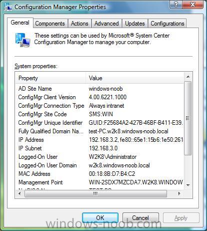

Screenshots of the Configuration Manager client

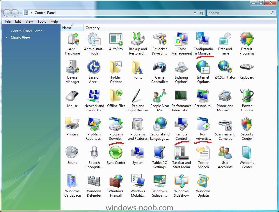

Below are some screenshots of the Configuration Manager client installed using this guide on a Windows Vista Ultimate machine (test-pc).
Here's the control panel with some new icons from SCCM
and here is the Configuration Manager client General tab

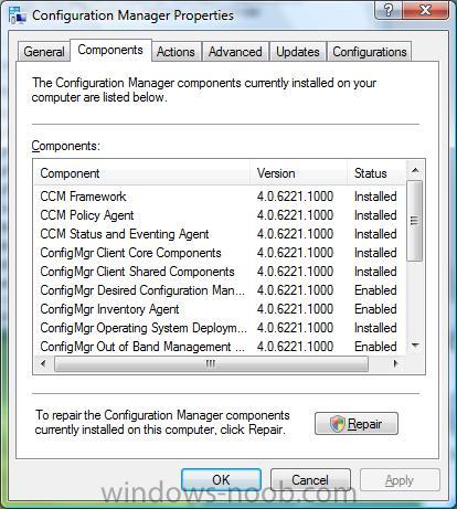

the components tab...

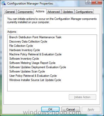

the Actions tab...

If you have pushed out the client install and you don't see the Configuration Manager listed in control panel, then make sure you are doing the client push installs with a user that has local administrative rights on the client pc, plus for troubleshooting check c:\windows\system32\ccmsetup and look at any LOG files present for errors.
