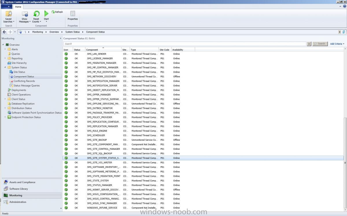

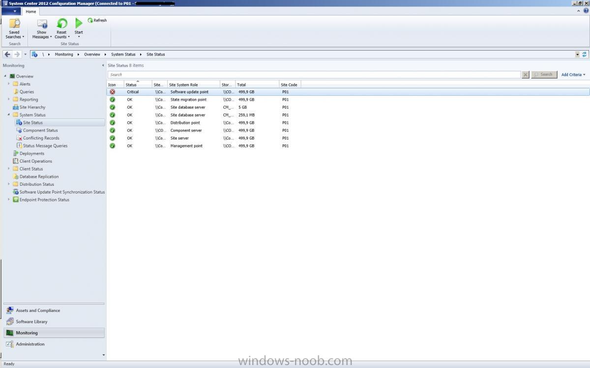

I made screenshots from my Component Status and Site Status. All ´OK´ only software update point isn´t. I selected to show all errors from the last year. So not realy much to see. Do you wan´t to see any log files? And which? -

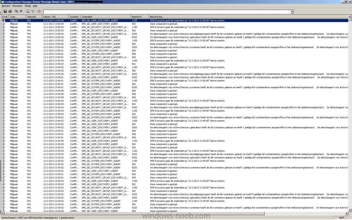

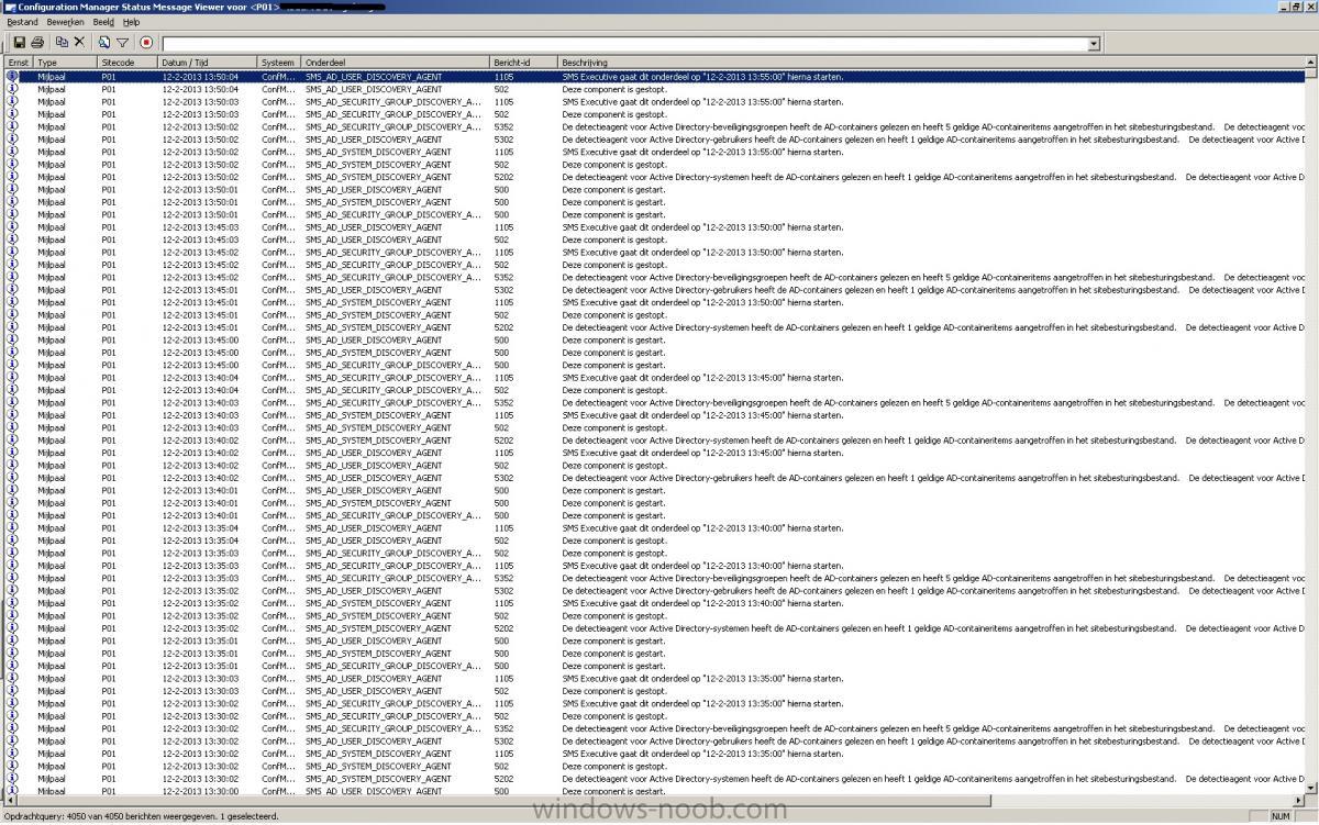

I've checked the log files mentionend earlier. I've checked all component status messages and i've checked many log files in the log directory. But couldn't find any related error. -

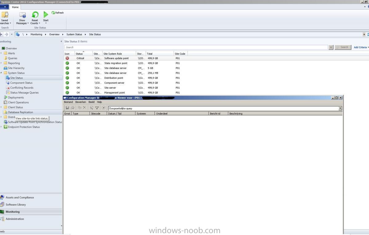

I've already deleted all the critical messages and resetted the counts. Didn't help. Still 'Critical' Today I deleted all messages in Software Update Point and resetted the counts. Still 'Critical' -

"Reset Counts > All" Works for my Component Status messages. But they are all 'OK', but for my Site Status > Software Update Point it doesn't work. I always have to check if there are any Errors in it because it stays on 'Critical'. -
We've installed SP1 for System Center Configuration Mangaer 2012. I had to fix some small things for the Software Update Point. I deleted all errors for Software Update Point. All the Component Status are 'OK' and the all other Site System Status are 'OK' Only the Software Update Point says 'Critical' Is there any way to reset the status?
