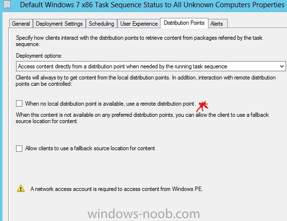

Are the packages in the shares at the remote DPs locations? Are your Boundary Groups & DP Groups configured properly so that any system with in that boundary gets software from the local DP? You could deploy your TS and do not tick the option to allow the use of a remote DP, this way if content is not available on the system(s) being OSD'd local DP the TS will complain that SITECODE***** package is not available on the DP. One way of finding out for sure whether or not content is available.
