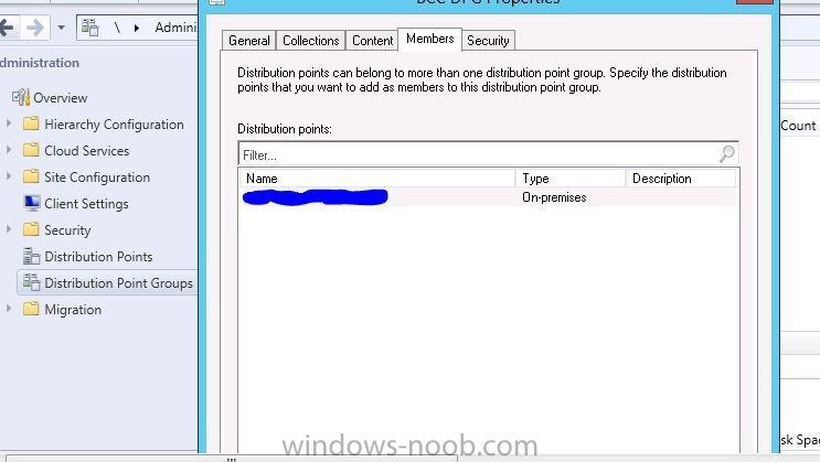

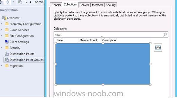

No I mean Distribution point groups. Create a DPG with your DP\SMP added as a member. Then add a collection with your system in it to this Distribution point group...see if this resolves your random SMP issue. As mentioned I briefly tested this before when I had a hub spoke topology with PS as hub and remote DPs as the spokes so to speak. I had a SMP configured at the PS DP(hub) and tried to USMT a system that resided on a spoke location, it worked but it captured the data to the PS SMP which did take quite a while over the WAN link. I added a SMP to the remote DP server where this system resided and configured the above distribution point Group solution and it worked fine, it captured the data to the remote DP/SMP where the system resided as opposed to coming across the WAN link.
The machine in question is a member of how many collections? Is there is a common collection associated with many distribution point groups, don't use USMT but did test it briefly and if I remember I had to isolate any system I was trying to state restore into a collection that was only a member of a distribution point group that only had the DP with SMP configured, once this was done it captured the settings to the correct local SMP that the system resided at.

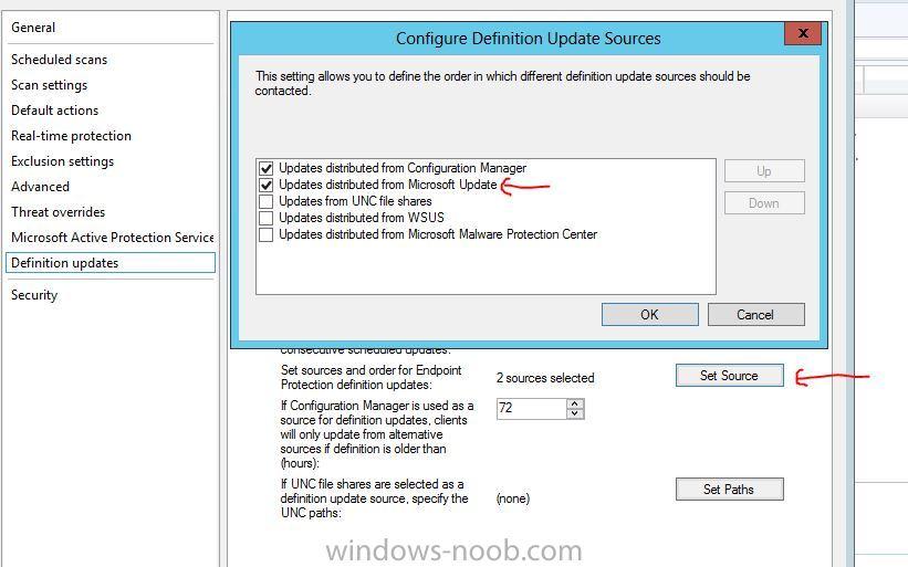

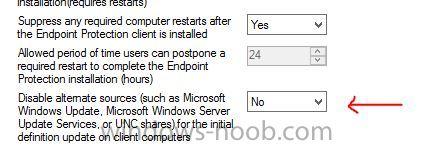

Rocket Man replied to sanja's question in Endpoint Protection
On the 2nd part...losing connection to SCCM server there is actually settings in the client and antimalware policies that allows the AV to go out to Microsoft update for definitions if it is not connected to the Configmgr network. Proves very useful in scenarios where you deploy work group or domain joined systems that will be out in the wild and disconnected from the Configmgr infrastructure, otherwise when the user manually tries to update the AV from the console it will error out, and if they don't have local admin rights they will not be able to change this setting with the windows update settings on the system. -

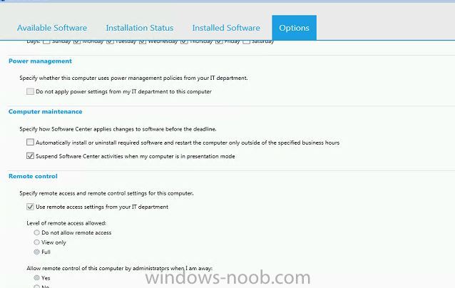

The power management can be controlled via power management at the collection level. If you set power management on a specific device collection then the devices within the collection are governed via ConfigMgr policies, so the user has no control over this. The same go's for remote control, you specify the remote control options in the client settings. This takes precedence over a user trying to change these options.
