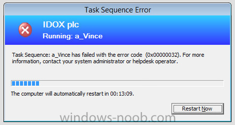

Task Sequences fail since upgrading to 2012 R2 SP1
vincelewin replied to vincelewin's topic in Configuration Manager 2012
My problem was due to another administrator in my domain deleting the account I had configured SCCM to use. I recreated it and a whole host of issues dis-appeared. -
Cheers guys. I found the issue. Someone deleted the account i was using. I recreated it and its working again.
*bump -

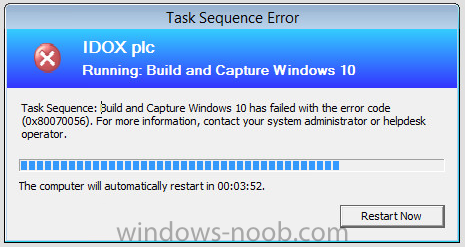

Hi please see attached logs. smsts.log smsts-20160129-222124.log
Hi Anyweb, I am using 2012 R2 SP1 CU2. Windows 10 Ent The ADK version is Which logs should I attach?
Yeah when I go to control-alt-del it is joined to the domain and the computer account has been created in the OU I specified. I can login successfully. I have changed the order of the task sequence and put the config mgr client to the end, now it fails with an error. -
Hi All, I am hoping someone can help me. I recently upgraded my sccm server to 2012 R2 SP1 and now none of my task sequences complete, they put the image on, install drivers and install the Config Manager client but then it all stops. I have windows updates, application installs after the config manager client and they all fail. I have created a new task sequence to test with thinking maybe it was just affecting historic sequences but its affecting all. I don't know where to start with trouble shooting this and when I find logs on the client I don't know how to decipher the cryptic text. Can anyone help? dism.log smsts.log smsts-20160128-170943.log

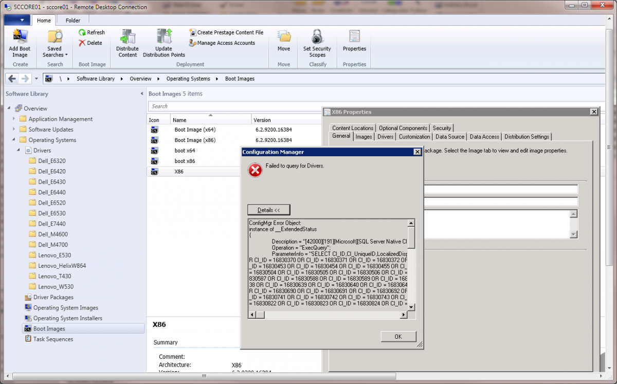

Can anyone explain why I am seeing this? I have recreated the boot image and added the desired drivers to it but I still get this error. Thanks in advance for any help. Vince

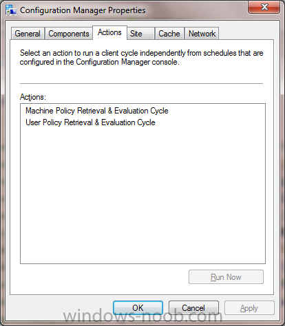

I hope someone can help. I have pushed out the client to a windows 7 machine from my 2012 sp1 sccm server. It has installed but under the action tab only shows two options, "Machine Policy retrieval and evaluation" and "User policy retrieval and evaluation" I know there should be more than just two but cannot fathom out where they have got to. Please help! Vince
