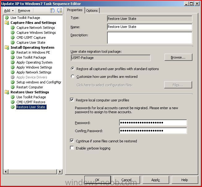

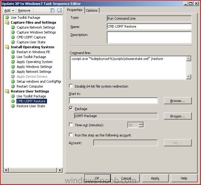

  14. Hi all, I deed some tests with SCCM2007, USMT 4.0 and MDT 2010 to update WinXP to Win7. Everything go’s well until the second last step, then I get the following error 0x00000024 :angry: Can someone help me with this problem? In attachment you will find my 2 SMSTS.logs files Thanks
  15. anyweb Can you tell me where you opened the new topic for USMT 4.0 I have tested again and it fails on the restore with error 0x00000024

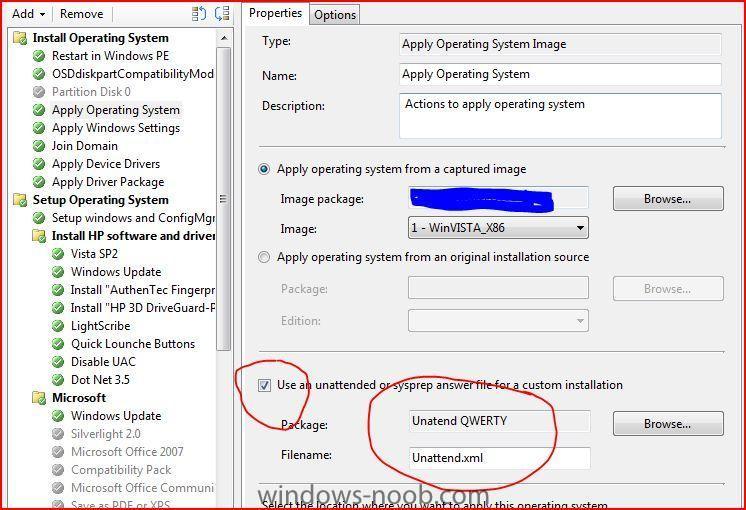

  20. Use an unattend.xml create a package, no program en ad it to the distribution point. in the apply operating system step select the Use an unattended or sysprep, select the package and enter the unattend.xml file. For example: <?xml version="1.0" encoding="utf-8"?> <unattend xmlns="urn:schemas-microsoft-com:unattend"> <servicing> <package action="configure"> <assemblyIdentity name="Package_for_KB935509" version="6.0.1.9" processorArchitecture="x86" publicKeyToken="31bf3856ad364e35" language="" /> </package> <package action="configure"> <assemblyIdentity name="Package_for_KB937287" version="6.0.1.18000" processorArchitecture="x86" publicKeyToken="31bf3856ad364e35" language="" /> </package> <package action="configure"> <assemblyIdentity name="Package_for_KB938371" version="6.0.1.25" processorArchitecture="x86" publicKeyToken="31bf3856ad364e35" language="" /> </package> </servicing> <settings pass="specialize"> <component name="Microsoft-Windows-IE-InternetExplorer" processorArchitecture="x86" publicKeyToken="31bf3856ad364e35" language="neutral" versionScope="nonSxS" xmlns:wcm="http://schemas.microsoft.com/WMIConfig/2002/State" xmlns:xsi="http://www.w3.org/2001/XMLSchema-instance"> <StartPages> <StartPage wcm:action="add"> <StartPageUrl>http://www.google.be</StartPageUrl> <StartPageKey>Home</StartPageKey> </StartPage> </StartPages> <CompanyName>BlaBla</CompanyName> <Home_Page>http://www.google.be</Home_Page> <IEWelcomeMsg>false</IEWelcomeMsg> <TrustedSites></TrustedSites> </component> <component name="Microsoft-Windows-Shell-Setup" processorArchitecture="x86" publicKeyToken="31bf3856ad364e35" language="neutral" versionScope="nonSxS" xmlns:wcm="http://schemas.microsoft.com/WMIConfig/2002/State" xmlns:xsi="http://www.w3.org/2001/XMLSchema-instance"> <Display> <HorizontalResolution>1920</HorizontalResolution> <VerticalResolution>1200</VerticalResolution> </Display> </component> </settings> <settings pass="windowsPE"> <component name="Microsoft-Windows-Setup" processorArchitecture="x86" publicKeyToken="31bf3856ad364e35" language="neutral" versionScope="nonSxS" xmlns:wcm="http://schemas.microsoft.com/WMIConfig/2002/State" xmlns:xsi="http://www.w3.org/2001/XMLSchema-instance"> <Display> <HorizontalResolution>1920</HorizontalResolution> <VerticalResolution>1200</VerticalResolution> </Display> <DynamicUpdate> <Enable>true</Enable> <WillShowUI>Never</WillShowUI> </DynamicUpdate> </component> </settings> <settings pass="oobeSystem"> <component name="Microsoft-Windows-Shell-Setup" processorArchitecture="x86" publicKeyToken="31bf3856ad364e35" language="neutral" versionScope="nonSxS" xmlns:wcm="http://schemas.microsoft.com/WMIConfig/2002/State" xmlns:xsi="http://www.w3.org/2001/XMLSchema-instance"> <OOBE> <HideEULAPage>true</HideEULAPage> </OOBE> </component> </settings> <cpi:offlineImage cpi:source="wim://sccm/packages$/test-xml/install.wim#Windows Vista BUSINESS" xmlns:cpi="urn:schemas-microsoft-com:cpi" /> </unattend>
