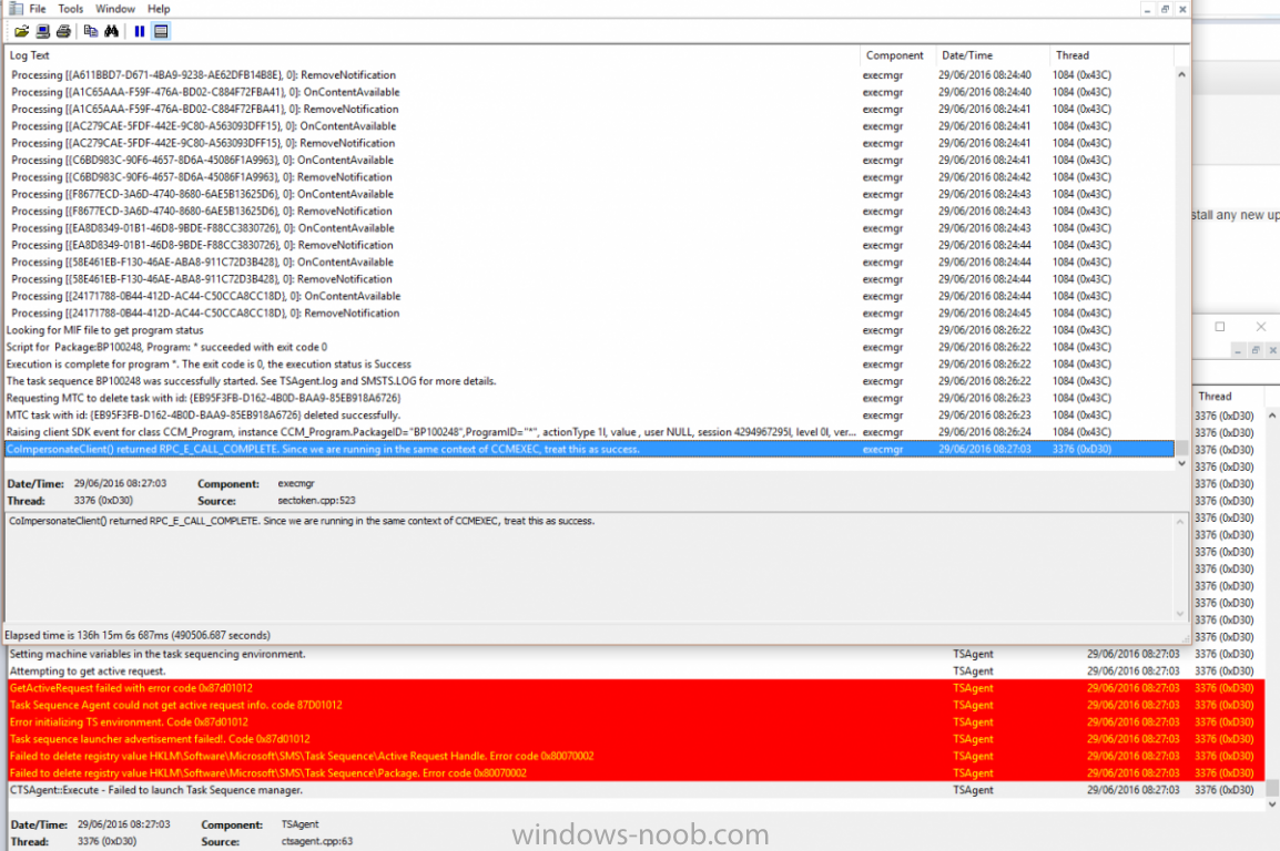

Well just to give you more of an idea. So i tried it on a windows 10 machine as you know and it worked. This then installed Windows 7 because that's the TS i selected. I then tried reinstalling the same TS and that worked too. So i don't understand why it can be the imagine when it worked this time when starting from Windows 10, but doesn't work with machines that started on that TS.
Hi Jorgen, Thanks for the response, I'm seeing this everywhere. Even with freshly built PC's. The client seems to do everything else correctly. It reports back as expected, it will install any new updates or software, just won't install Task Sequences. Despite the fact the Task Sequences work via PXE. Thanks, Craig.
Hi, So i have recently upgrade to 1511, i believe since then I'm unable to install Task Sequences via Software Center. When i select a TS, for example the TS used to build the machine Software Center displays Downloading then Installing for about 2 minutes, then installed. During this process there are no smsts logs created, but the TSAgent log does display this error message at the end. So far i have created all new TS's, redistributed the Boot image and OS image, checked all the applications can install without being deployed and updated MDT to 2013 update 1. The task sequences do work when booting from PXE. Any Advice would be appreciated. Thanks, Craig.

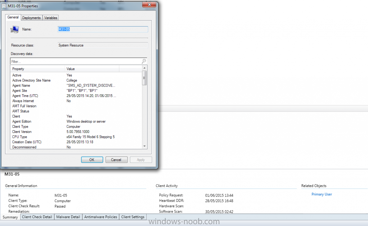

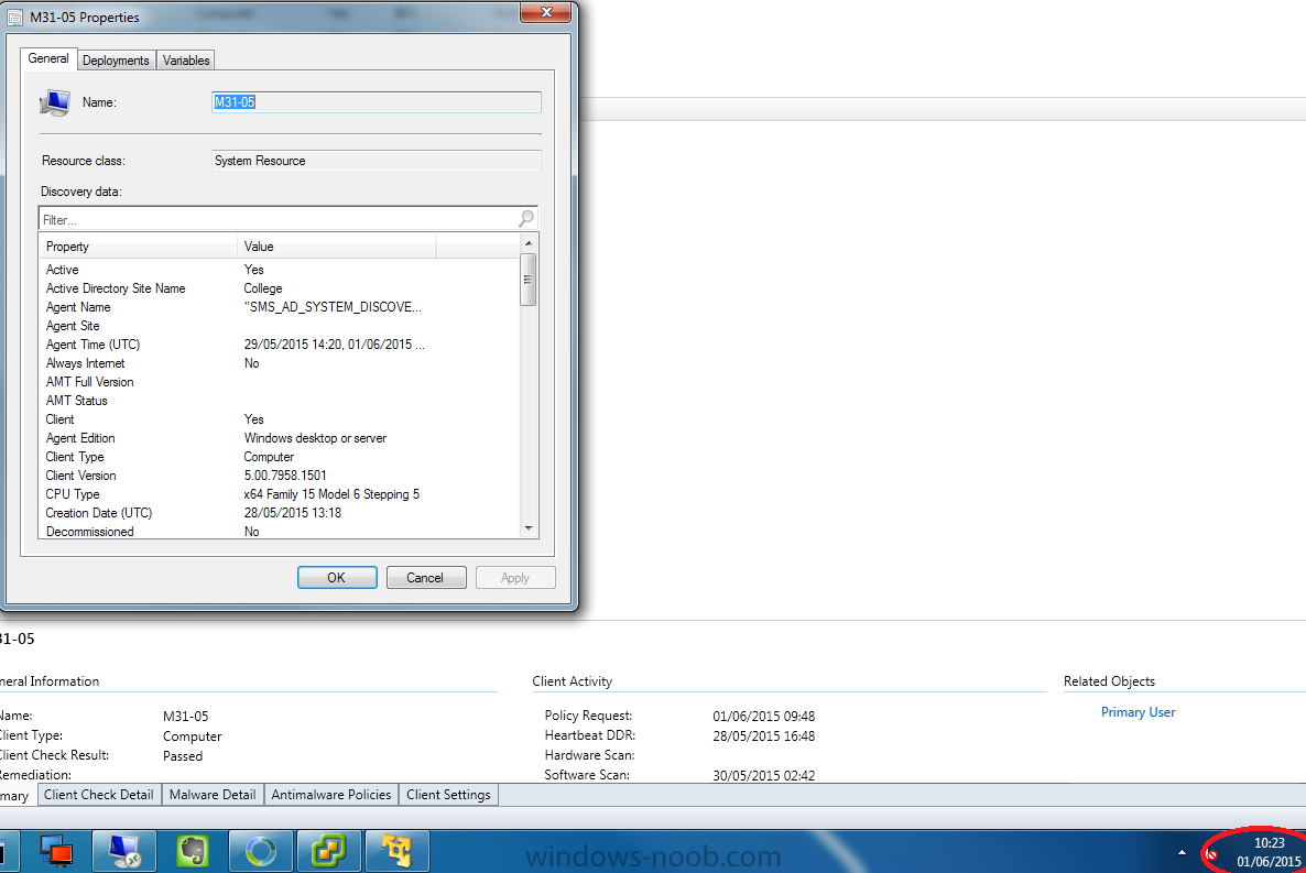

Ok so the first screen shot is just as the pc has turned on, so about 10 mins after boot. As you can see both properties menu report the correct client version. The next screenshot is about 45 mins later. -

Hi, I will do my best to explain the issue i am having but it is a weird issue. We have a collection set up that shows us any client that is not on R2 CU4, Upon monitoring this i have noticed that i have a lot of workstations sat in this collection that have recently been re-imaged with a task sequence that uses CU4 in the wizard. i have checked the client manually and it seems to have built correctly, it has all the right software all the actions and it reports to have the correct client version. (5.00.7958.1501). Yet when i check in configuration manager on the properties of that client, the version is 5.00.7958.1000. These workstations have been stuck in this collection and like this for about a month. I checked and most of these workstations have had a heartbeat update within the last 2 days. I also believe this issue is related to why in my recent batch of updates they are reporting as unknown even though i have checked on the Clients themselves and they seem to have installed the updates. Any ideas will be appreciated. Thanks.
