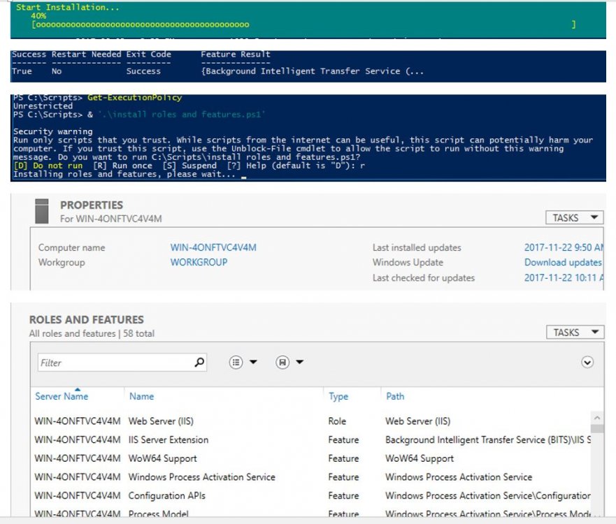

  13. Tested your xml file to install roles and features on a VM. It worked out fine. No need to include server name. Just run the install roles and features script and all the roles/features will get installed in less than 4 minutes. Will save the script for future use. Here is the screen shot for information.
  14. HI - Excellent notes. Thanks for sharing the scripts. My question is - I would like to make use of your XML file for deploying roles and features. Do, I need to specify servername while running install roles and features.ps1? As you know the computername in the XML file is CM01. Thanks RL
  15. Don't forget to replace computer name in DeploymentConfigTemplate.xml as it contain different computer name.
